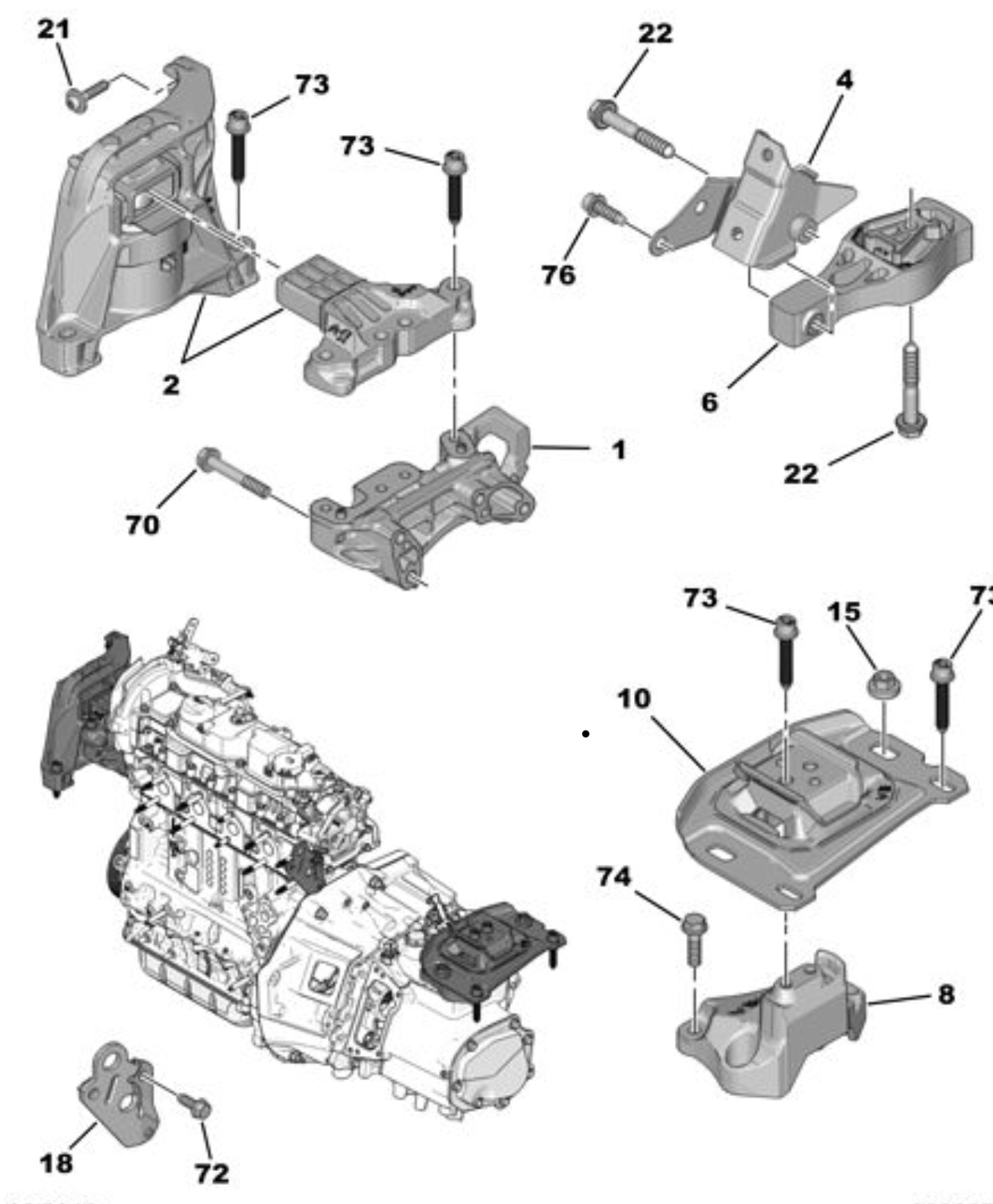

Hi,
I've found a guy on a Russian website that details changing the bushes on the 2 engine bay support beam shock absorbers (I don't know their actual name). Google translate isn't too good translating the guy's installation instructions.
My passenger side one rattles - I can reach down into the engine bay and rattle it with my hand.
The driver side seems to still be quite solid.
So I was going to replace the passenger side end bushing part.
The number of the left silent block is 16 108 281 80 .
The number of the right silent block is 16 108 282 80 .
Would you be able to show me the service manual image showing the parts and bolts etc - then I can work out how to remove it?
The beam is secured at the front end of the vehicle with M10 and M13 bolts, but I want to figure out their location and plan it before I actually start the job.
My VIN is: VF7**************[VIN obfuscated, can be read by forum staff]
Thanks
x 6956
Re: C4 Picasso - engine bay shock absorbers
These are the engine mounting brackets
Unread post by RichardW »
They're part of the front subframe assembly, Marc....
Unread post by danlat1415 »
Exactly what I needed - Thanks RichardW
Thanks Marc, but as Richard said, you'd got the wrong mounting brackets.
Thanks both!
