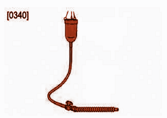

Tooling
| Topping Up Cylinder |
Always replace the Drain Cap Seal and the Gearbox Oil Filler Seal
CAUTION: The gearbox must be drained when the oil is hot (60 °C minimum), to eliminate the impurities suspended in the oil.
Remember you cannot fully empty the gearbox. The total capacity (dry) is 7 litres and only 3 litres will drain out - with the remaining 4 litres the remaining in torque converter / box. This is why several drains over a short period of time are as near as you will get to a total swap.

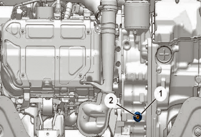

- Put the vehicle on a hoist.
- Remove the under engine protection .
Remove:
Refilling
Fit:
- The oil overflow and drainage plug (1) (equipped with a new seal)
- The top-up plug (2)

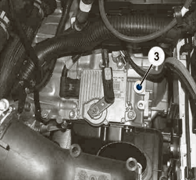

| Remove the filler plug (3). Use the filling tool |
Refit the filler plug (3) (equipped with a new seal).

- Remove the filler plug (3)
- Add 0.5 additional litres of oil in the gearbox
