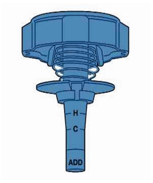

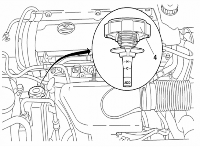

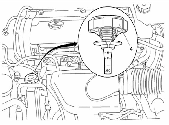

Check the levels and that you have bled it properly:
Fill the power steering reservoir to the mark ( C) on the filler cap (4).
Engine stopped: Slowly move the steering, from lock to lock, in both directions (about 10 times).
Bleeding
Turn on the engine and let it idle for 2 to 3 minutes, without moving the steering wheel.
Keep the fluid level topped up.
Bleed the circuit by turning the steering several times in each direction.
Level
(H): Maximum level (engine warm).
(C): Maximum level (engine cold).
(ADD): Level minimum.
The oil level must be checked/topped up with the engine off.
Bleeding
Level
