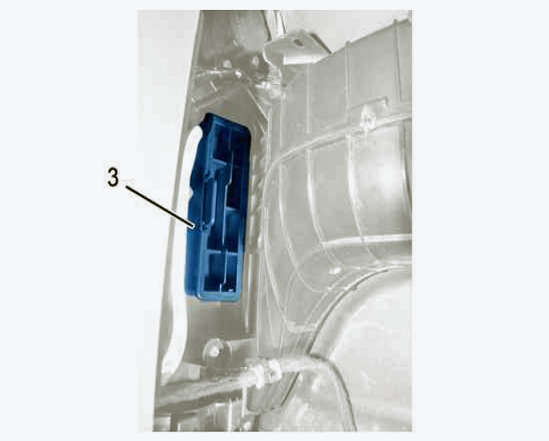

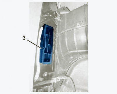

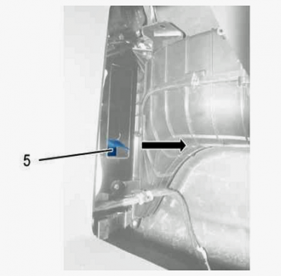

On a Left Hand Drive. officially, the glove box needs to be removed to get access - but I can't tell you whether it is achievable without doing this (in the case you have twiglet fingers). The instructions below are therefore applciable to a left hand drive - there are no specific instructions for a right hand drive, so I would expect access to be easier with no glovebox.
On these, there are typically 2 filters. Once has to be removed, and the other then lifted up and extracted afterwards.
The pollen filter is in the same place regardless of right or left hand drive, as they are the same heater units.
Remove:
| Unclip and remove the pollen filter flap (3). |
| Remove the first pollen filter (4) (In the direction of the arrow ). | Slide the second pollen filter (5) upwards. Remove the second pollen filter (5) (In the direction of the arrow ). |

Guys - I do apologise - I revisited this and have updated my posts above for clarification and correction. The diagram in my posts above I have added to clarify. On the DS5 specifically and all incarnations of it, the pollen filters are on the right hand side as viewed sitting in the car. They are always on the right regardless of the RHD / LHD version, which remains correct.
The diagram I have now added in my previous post above threw me initially, as it shows the engine facing side, along with a poor procedure that does not specify it was for LHD vehicles which of course would require the glovebox (on the right hand side on a LHD car) being removed, which it of course does not on a left hand drive.
So for right hand drive vehicles there is no glovebox to worry about. Just access from the driver's side footwell. I've edited my posts above to avoid confusion and clarify.
Sorry for the confusion - especially to farhanuk77
