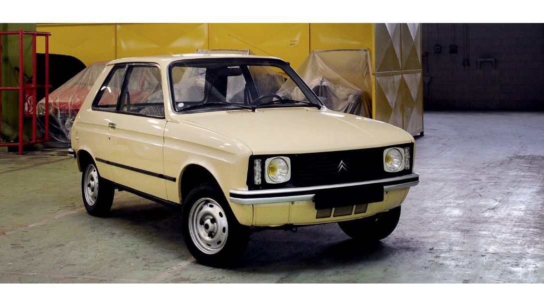

Is there room in your garage for this Jim?

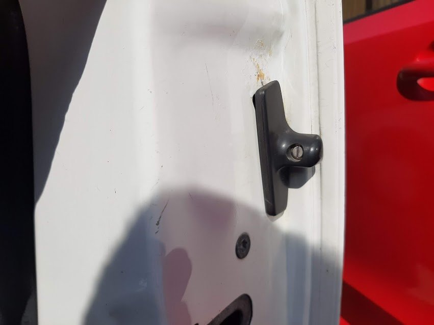

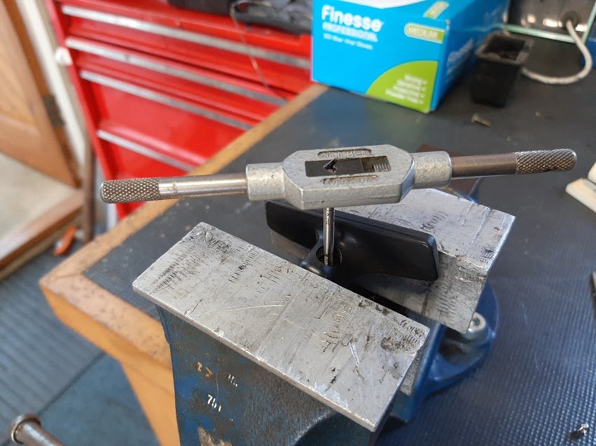

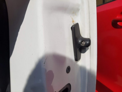

Then I came home and got cracking on Daffodil :) I started by fixing her door handle knob which had lost a rivet and would not stay put...
The rivet I replaced with a M3 screw which required a thread to be tapped in the knob...
Tapping the knob...
Tapping the knob...
It's good :)
Knob in place and fixed

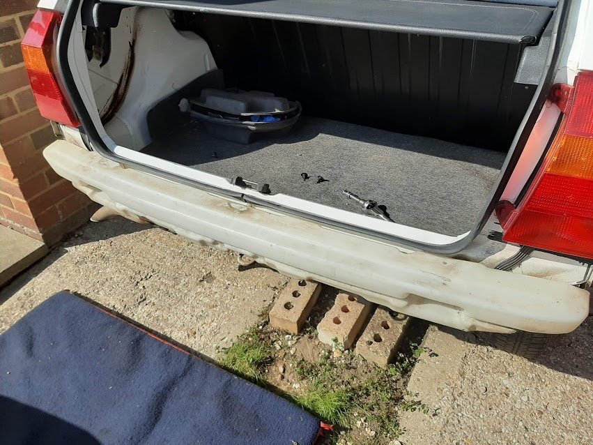

Next up was the misaligned rear bumper... I removed the bumper...
Inner Bumper
Inner Bumper
Then the inner bumper...
No bumper at all...
No bumper at all...

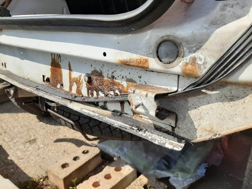

And found a bent bracket...
Bent inner bumper bracket
A few gentle bending adjustments and the rear bumper is now good and straight :)

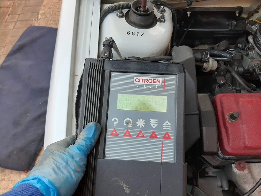

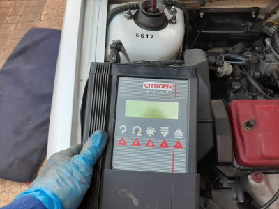

Next up was an ELIT session on her engine ECU... Luckily, I found my two-pin diagnostic cables when tidying up :)
ELIT tests
ELIT tests
All is good except the oxygen sensor is a little sluggish... Might have to swap it before the MoT...

You can have this LN Jim, Its a bit off-white/cream nothing that a brush and a can of dulux brilliant white wouldnt sort out :-D

Oh yes please :D Reminds me of the Old English White my very first car, a Mini, was painted in...
I like it, no need for the Dulux dog to bring me a can of Brilliant White ;)

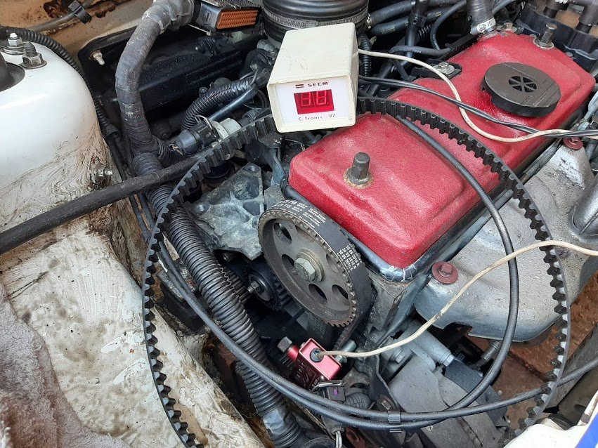

Daffodil has today been fitted with a new cambelt :D The first replacement I believe she's ever had judging by the pristine nature of things down there :)
SEEM Gauge in use...
I even used my SEEM gauge to check the belt tension!
It's ever such an easy job in an AX but not quite as easy as in the Saxo as space is tighter and the ECU gets in the way...

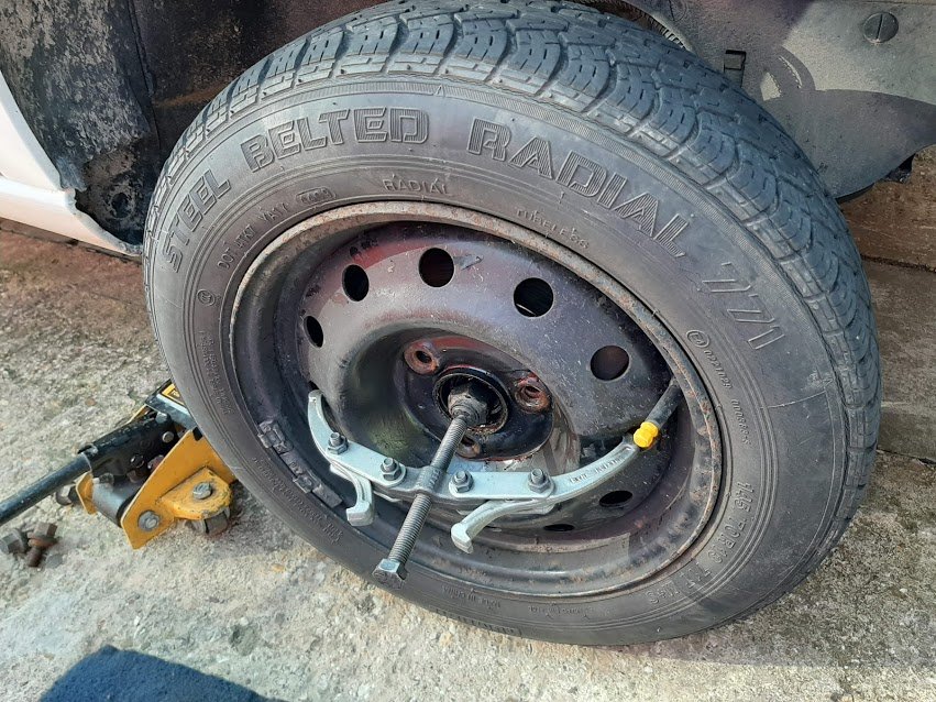

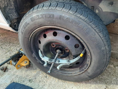

The hardest job was getting the front wheel off :shock: Rust around the centre hole held it fast...
A puller made short work of it and easier than hammering the wheel off ;)

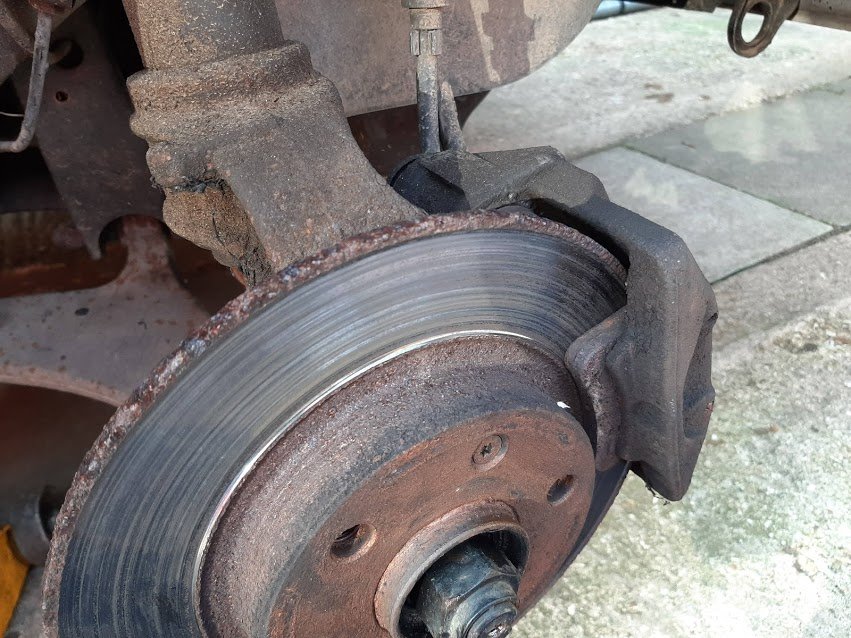

I then saw the front discs and pads are not far off needing replacement... A job I'll do along with wheel bearings and driveshaft before the MoT...
A bit worn!
A bit worn!

Very nice Jim - especially using the SEEM meter ....never actually seen one before I believe they are very reassuring rather than guessing the belt tension :roll:

Skull wrote: 20 Sep 2020, 19:09 Very nice Jim - especially using the SEEM meter ....never actually seen one before I believe they are very reassuring rather than guessing the belt tension :roll:
Absolutely so :) It's like using a torque wrench on critical nuts and bolts - it gives peace of mind...

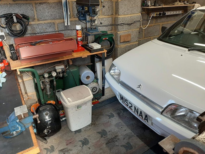

Meanwhile Daffodil slumbers in her cosy garage... It's a real precision, but surprisingly easy job to park her despite there being less than an inch clearance all round :shock: I even have to chock one of her rear wheels so her rear bumper doesn't touch the garage doors...
