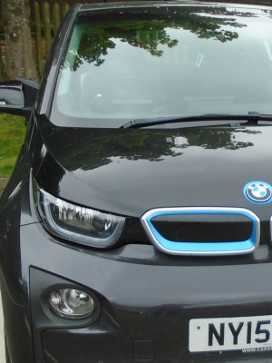

The BMW I3 REX with the range extender scooter motor might do it for you Gibbo, but it can't be considered to be a contender in a bargain basement electric thread, High milage 15 reg £12,500, still overpriced despite dropping like a depreciation stone from its original sale price of nearly £40,000 for the REX model.
Spoted this one today From the same seller Carshop.co.uk according to the numberplate

Lambretta or Vespa?
Sorry, couldn't resist... I'll get my coat...
