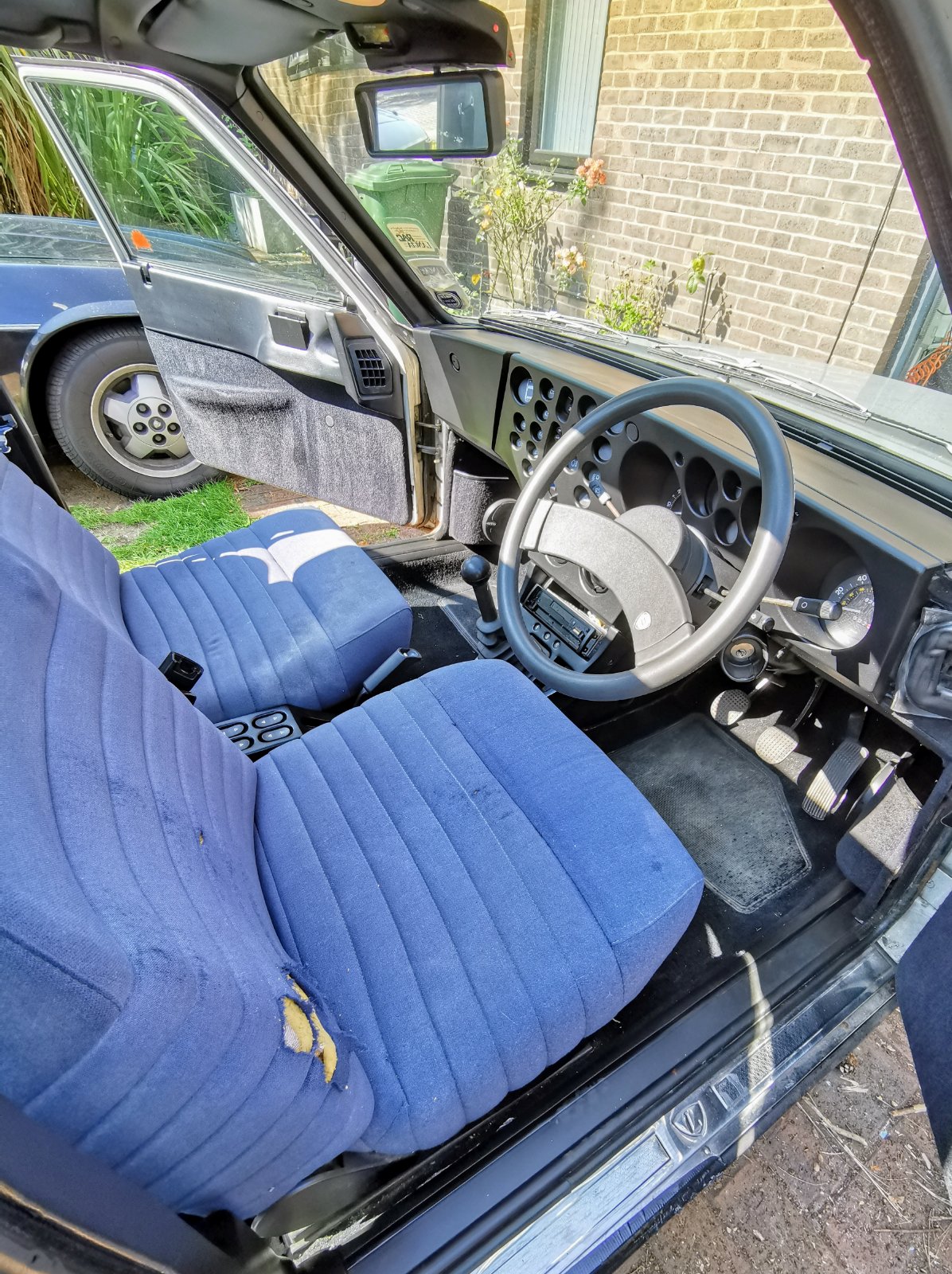

Looked a bit better once the interior was cleaned...
Real shame about that damage to the driver's seat bolster as the interior other than that is in astonishingly good shape for a 37 year old Lancia.

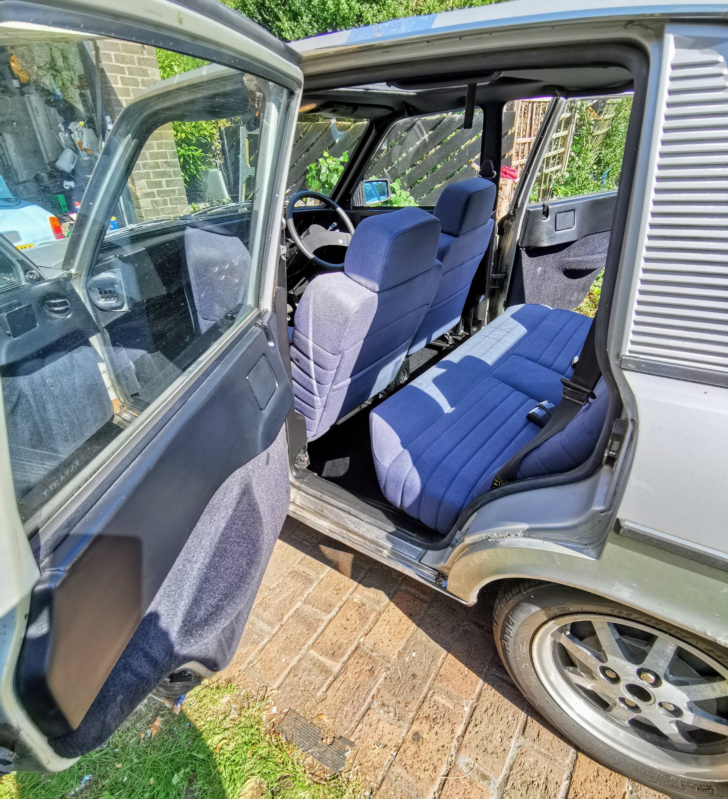

One very important job was still pending though! Cleaning! I'm not too worried about disturbing well earned patina here as I know from the auction photos from back in 2017 that she was valeted before that sale...so is just grubby! The outside I'm leaving be (not least because of not wanting to accidentally remove any of the structural duct tape) for now, but I'd like to spruce up the interior a bit. That's the bit you spend the most time with after all.
Firstly I went through the car with a fine tooth comb, gathering all the parts, nuts, bolts, screws, washers...and a tiny stubby ratcheting spanner...into a box in the boot so I didn't end up accidentally vacuuming up something important. Especially given how many of the interior fittings and bits of trim on these cars are made of purest unobtanium. Then we got to work.
Starting point in the rear:
After a vacuuming (carefully as I had no idea how fragile the seat cloth was - turned out to be fine in general) it looked a bit better.
The amount of spiders evicted was biblical. Plastics still need gone over back here.
Up front was even grubbier. Sadly there's a little bit of water staining on the passenger seat presumably due to a leak from the sunroof somewhere in the distant past.
Another half hour made quite the difference.
While the rear still was waiting for the plastics to be wiped down when we called it a day yesterday, she was looking like quite a different car!

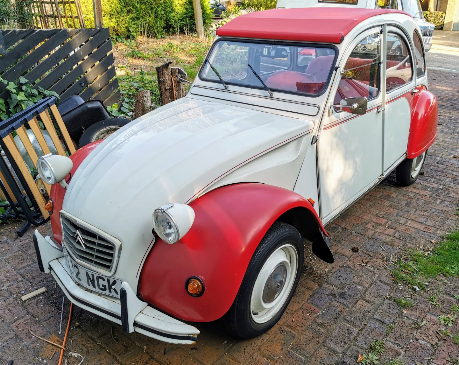

After that she was returned to her owner. Reckon she'll make another appearance on here once we've got hold of a carb overhaul kit and a new radiator for her.
Also realised when I got home that my camera mount is still stuck in the rear window. Oops. Will grab that next time I'm over that way.
Realising when I'd got there that I really hadn't thought about how I'd get home, we arranged for me to take another motor back home. While we're not aware of any immediately required mechanical work, she is in need of some cosmetic TLC as she's turned rather completely matt as light coloured cars tend to.
I don't usually and really don't like doing the whole blanking number plate thing out, but given that I'm well aware that these cars are being targeted a bit more these days I felt it was a reasonable precaution as this isn't my car. Was a bit pointless on the Trevi given there are only two of them on the road!
An interior which despite being as basic as they come, is surprisingly comfortable.
The windows desperately need cleaning...discovered that the first time I tried to turn out of a junction with the sun in my face.
I've heard a lot of people say that driving a 2CV is like riding a bike in terms of you remembering things quickly, and once the one inevitable "Is that 2nd?...No, that's 4th..." Moment had passed the rest of the trip passed uneventfully with me wearing s huge grin. I'd forgotten what fun cars these are. This is dangerous has it's definitely got me pondering one again!... Exactly as I feared!
No issues with the dashboard illumination in this car at least!
So we'll see how I get along with it for the next couple of days...Am I going to end up with a 2CV on my shopping list? I am aren't I...
