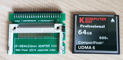

I am replacing the HDD with a CF as it is rebooting and it is getting more frequent.
After fitting the CF card which has been formatted to fat32 and is set at slave the system powers up and starts the software update.
It gets to 67 % and fails with an error code 0x3019 and reboots and try's again to install software but gets to 67% an same problem it looks like it is in a loop.
If when it has failed i remove the CF card and check it on pc no partitions have been made.
If the original HDD is replaced the system boots up as normal.

Re: Guide to Replacing the NG4 Navidrive 3D Hard Drive with a CF Card
Perhaps the card is faulty. Do you have any software that could run a test on the CF card? I use Flash Drive Card Tester for SD cards and USB drives. I imagine that would work on a CF card as well.
Tested the card after second attempt with H2testw.
i can also access the card on a pc and write and read the contents.
Once formatted fat32 and refitted in the head unit the software upgrade does not even partition the drive.
The interface card with the CF card works when connected to a Pc.
- x 6956
Also provide the exact model of the CF card too please (model number) as some of these may not be compatible if they are too fast.
The CF card is the one recommended in the Guide
And this is the error message
