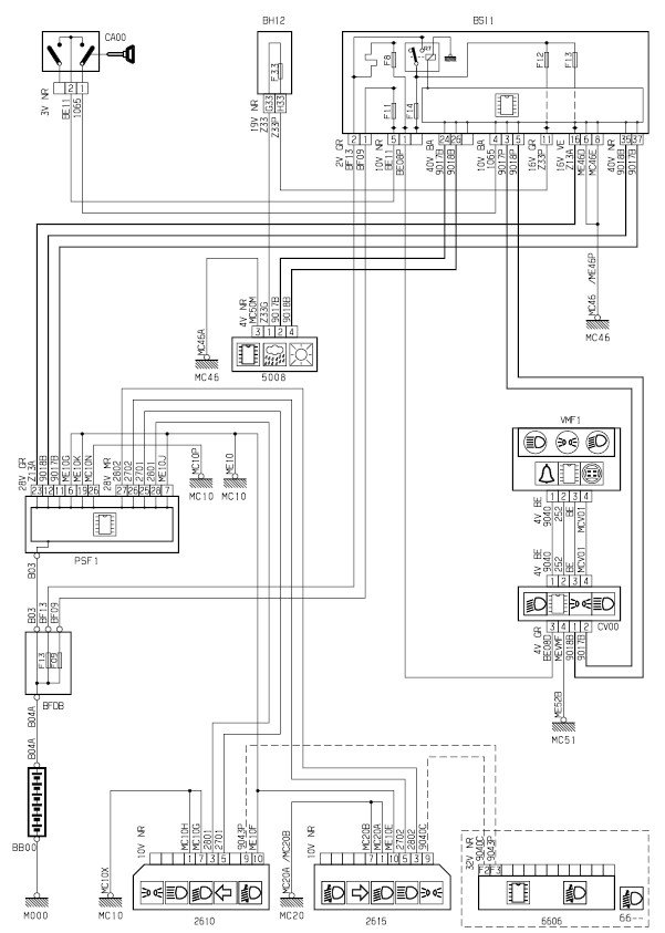

All the systems have there own diagrams so i have posted the headlamps diagram for starters, It shows the main supplies & data lines. CV00 is the com2000 unit.

Re: c4 1.6hdi comms ,
Thank you for posting.
I picked up a used comm2000 it was not too expensive cant say for sure if it working though.
The immob fault i think is due to comm2000 being down and not detecting the key.
