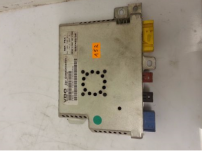

Re: Mk1 C5 Screen issues
If you are talking about the 7in colour MFD, it is likely you will need to replace the screen driver ECU (not the screen itself) VDO 22SY451. Details below. Failure modes include: yellowing, blue lines/flashes, reduced contrast and brightness, lines, intermittent operation, going blank periodically and then permanently. They are prone to temperature fluctuations. If you are (really) lucky, the inbuilt cooling fan may just need cleaning. There are a couple of 2nd hand units on Ebay, but they are not cheap.
Multi Function Display ECU
Fitted to Citroen C5 or Peugeot 604 2001-03 with 7” colour screen satnav
VDO 22SY451/35 (fitted to Citroen C5)
or VDO 22SY451/65 (identical unit fitted to Peugot 604)
See other ref numbers on photo2.
964552528000 FD0801040006933 PSA 96 388 795 80
NOTE: this is not the MFD screen itself, nor the satnav cd drive unit, but the ECU for the screen.
Location: Behind dash board on drivers side, behind the navdrive CD unit.

Thanks for that input and
to the forum. I see you have the same car as me which may prove useful in the future. I have had a look on ebay but I cannot find the right ECU at the moment. Do you know if I can access it through Lexia and check the cooling fan's operation from there?
Search Ebay for for "22SY451" . There are 4. The cheapest at £150 is not a bad price. I don't know about Lexia; I've ran my C5 for 19 years without one. However, I very much doubt that any vehicle diagnostics would "look inside" the ECU.
