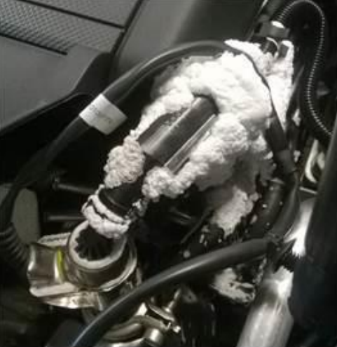

Yes - still under warranty - so take advantage of it. I've seen some pretty awful failures of these -
This is what can happen when there is a leak at the Adblue supply line to the injector - the Adblue dries and crystalises:
