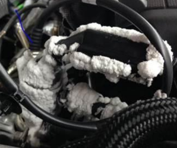

Yes - still under warranty - so take advantage of it. I've seen some pretty awful failures of these -bamo wrote: 24 Aug 2020, 13:57 update from dealer, says its the urea tank/motor at fault, replacing under warranty thankfully.
This is what can happen when there is a leak at the Adblue supply line to the injector - the Adblue dries and crystalises:
