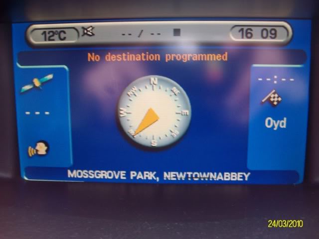

Like this one (picture borrowed from another post):
2001 Citroen C5 Mk. 1 Sat Nav Firmware Update?
