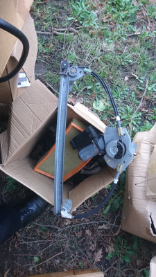

Going to try and upload some pics of my stores stash via my phone, give me a few mins to make sure it all goes well

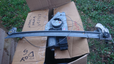

Re: And onto the next job! Window regulator Xantia X1 to X2
The following i believe to be from a MK2 Xantia.
If any of them look to be correct for you Roger let me know
Colin
Colin
Colin,
The first 2 regulators are Mk 2's and the 3rd photo is Mk 1.
Kenny
OK. Kenny. The one in the top photo is bob on identical. I se the cables are all over the place though. Did it fail on you or did you just disconnect the cables? If the cables are kinked, I’m probably no better off.
Having said that, take a look at my cables on the other post. Totally trashed!
Re-wrapping the cable on is probably going to be a mate. I obviously don’t know if there is a ‘resting’ position for the clip and the its position.
Roger those pics are from my spares stash, they are exactly as i got them so no idea if you can make a good one out of the lot
Colin
The ones which have just the bare cables are Mk. 2. The others where the cable has an outer sheath are Mk.1.admiral51 wrote: 07 Mar 2021, 14:53 Roger those pics are from my spares stash, they are exactly as i got them so no idea if you can make a good one out of the lot
Colin
Have PM'd you.
