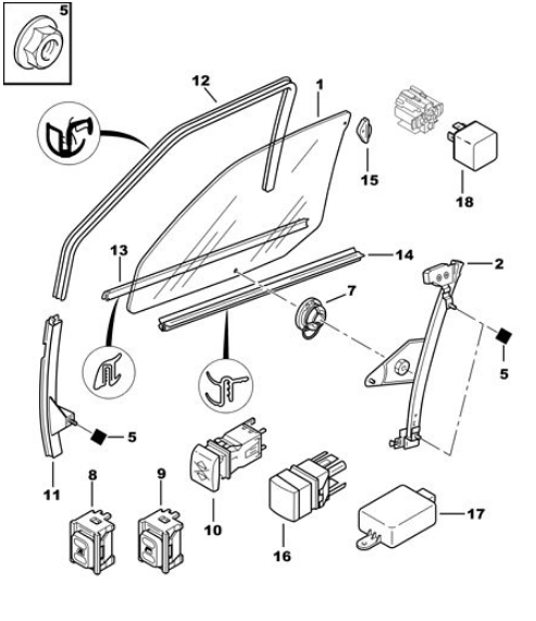

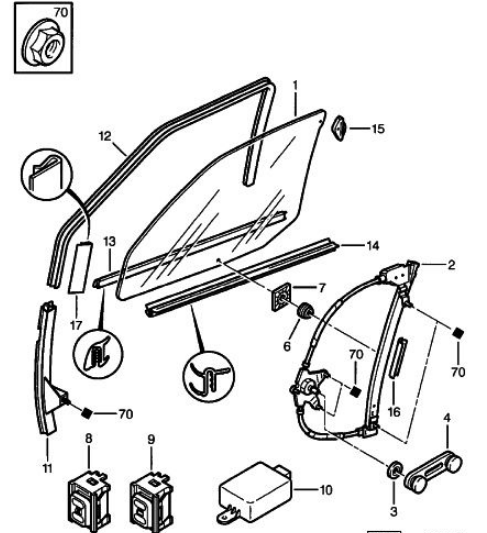

Item (2) left hand side units are the same part number, but the right hand side ones are different.Rhothgar wrote: 01 Sep 2020, 10:40 Guys,
Can anyone tell me to save me wasting my time stripping out a later S1 window regulator system, whether the part numbers are identical for this window regulator complete between this VIN ending 008E6285 (a late X1 and VF7**************[VIN obfuscated, can be read by forum staff]?
I imagine it's a mare of a job and one I will relish...
| Donor | Your MK II |
Part number for the Left regulator is 9221F8 on both vehicles.
Part for the Right MK II regulator is: 9222E0 and for the MK I is part: 9222F6
You have driver's front sequential window operation on your MK II.

I can see that the clip has broken so I will be able to get a replacement on Ebay. However, I see Citroen list them as Part 7?
You know when Citroen do this with part numbers ie 9222E0 and 9222F6 does it mean they are just an revised superceded design do you happen to know?

As far as part numbers go - the difference is usually design, function and compatibility for a specific build / year / model / option.
- Replacement (superseded) part numbers on the same vehicle are generally improvements / design changes over early versions of a part to compensate for problems.
- With different vehicles and facelfifted models where the original part numbers were always different, it is usually because of the design / application / option for the specific model in question.

When I put a Mk2 rear door on a late mk1 Xantia, I cam to the conclusion that the entire mechanism and (I think) glass were different and needed to be swapped from one door shell to the other. The change in design of the clip holding the glass to the mechanism is the key.
