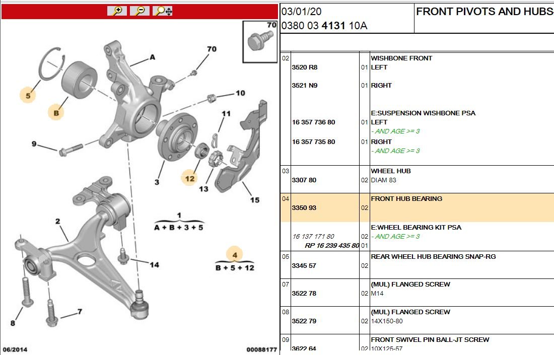

Afternoon, could someone confirm that my front wheel bearing is part no. 3350.93 and measures 86 OD, 45 ID and is 44 deep please?

Pop up your VIN, Pete, and we can check that pt.no. and maybe its size too.

VF7**************[VIN obfuscated, can be read by forum staff] Cheers Chris.

Hi Pete,
3350.93 is the right part no.
DISPATCH III SHORT PANEL VAN H1 TYPE 10 1.6 HDi 90 (DV6UTED4) Manual gearbox 5
Mister Auto has the bearing kit from several manufacturers.
Enter 335093 in the search box.

Thanks Chris, also the diagram will be very useful when stripping it.

Looks like the std PSA set up - remove the carrier, press / drive out the hub from the inside, remove the circlip, press the bearing out from the outside, remove the outer track that is stuck on the hub (angle grinder for a slit then chisel and hammer!). Refit is reverse of removal... make sure if it's got built in ABS track you get it in the right way round.

Thanks Richard, yep it looks straight forward, very similar to the one I did on the 406. It has got an ABS track integrated so thanks for the reminder. I will being nipping to my mates with beer tokens to do the pressing bit. Just ordered on from Misterauto, 56 euros all in SKF.
