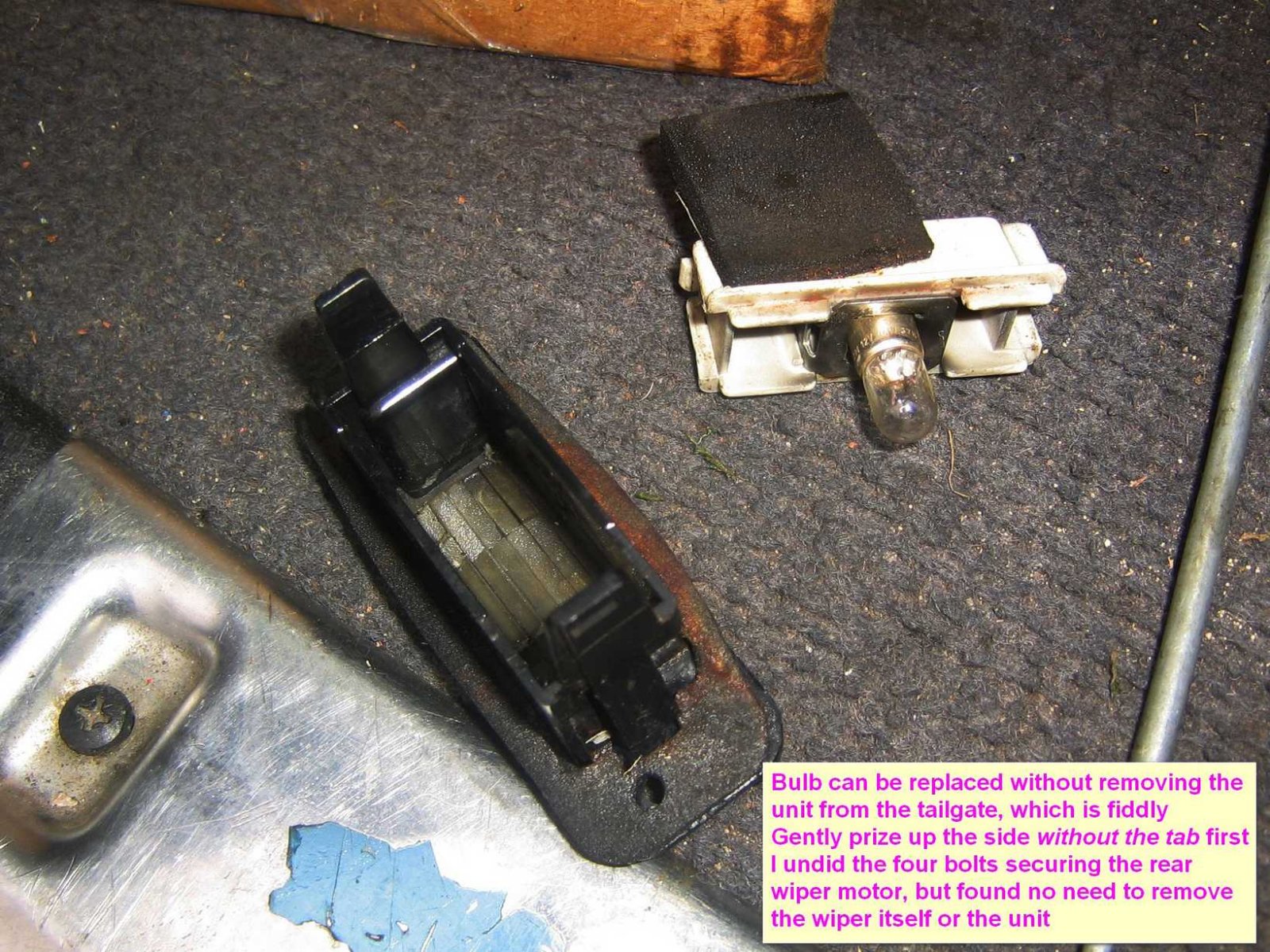

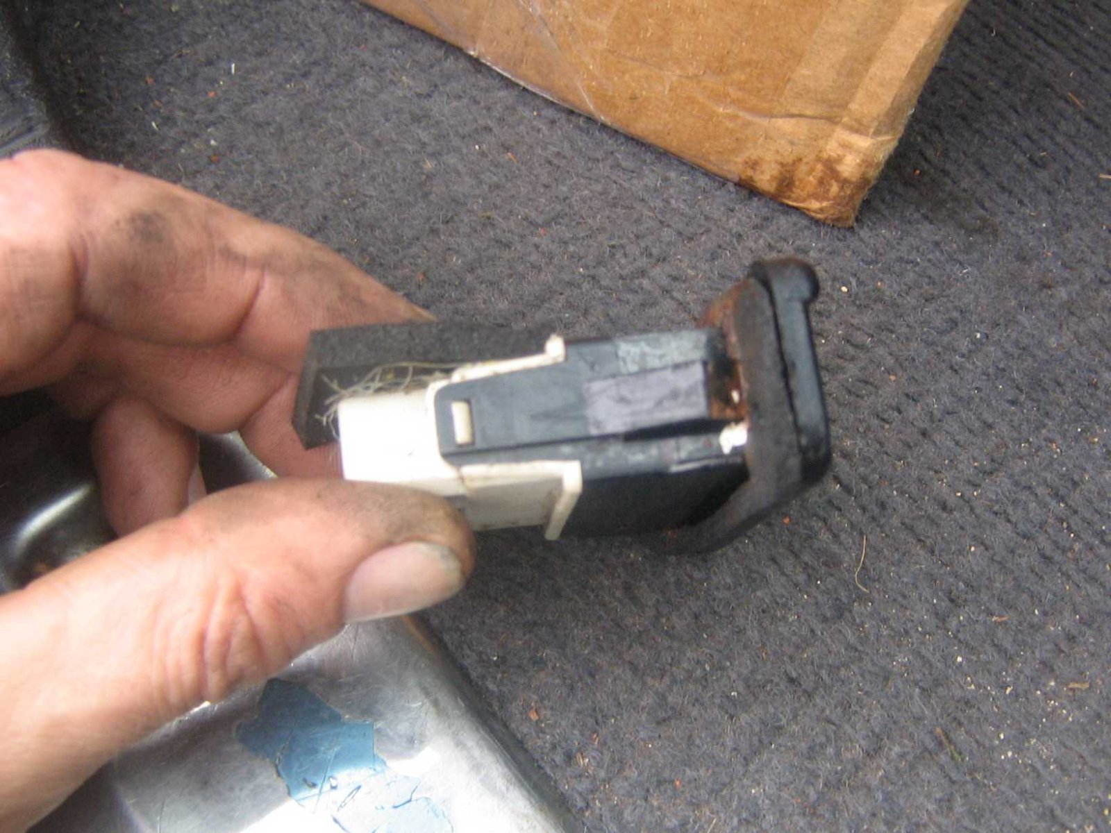

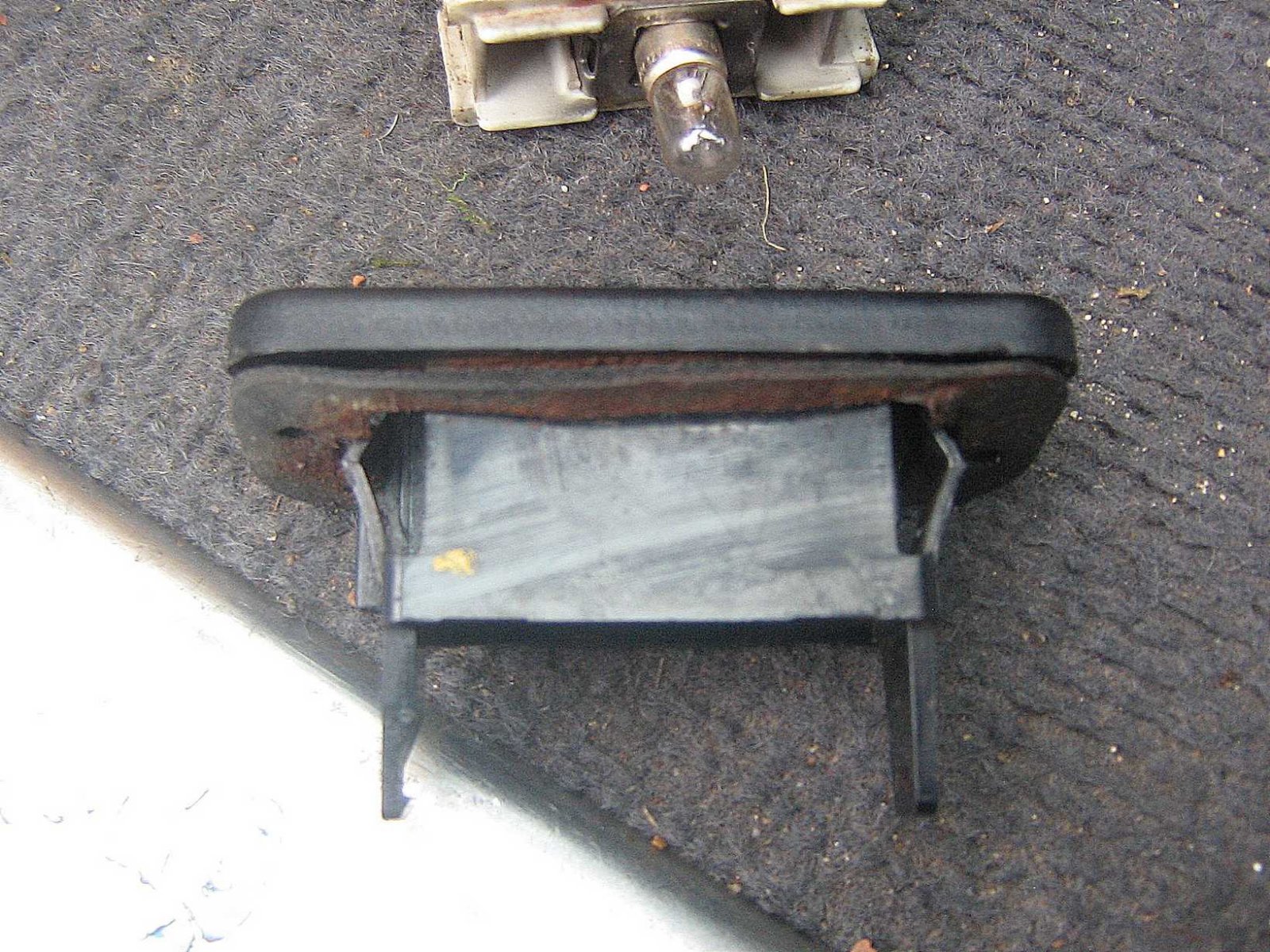

Can't be sure about the Xantia Estate, but I'd guess its likely to have the same set up as my 405 Estate of likely similar age (1995)
There's more than one way into the Number Plate light, see pics.

many thanks for your reply but I think my Xantia is different as the lamps are nowhere near the windscreen wiper motor, I think I will remove the tailgate inner lining and see it there is anything securing it from the inside as I said in my post it wont prise out as Mr Haynes suggests

That 405 number plate light in the photos looks nothing like our X reg 2.0l HDi estate number plate light holders, now sadly gone.
Neither will you find a way in from inside the tail gate, you will only disturb the plastic shield that prevents water getting in. They have used witchcraft to get a seal so unless you practice the black art and feel like a spending an uncomfortable half hour leave well alone.
