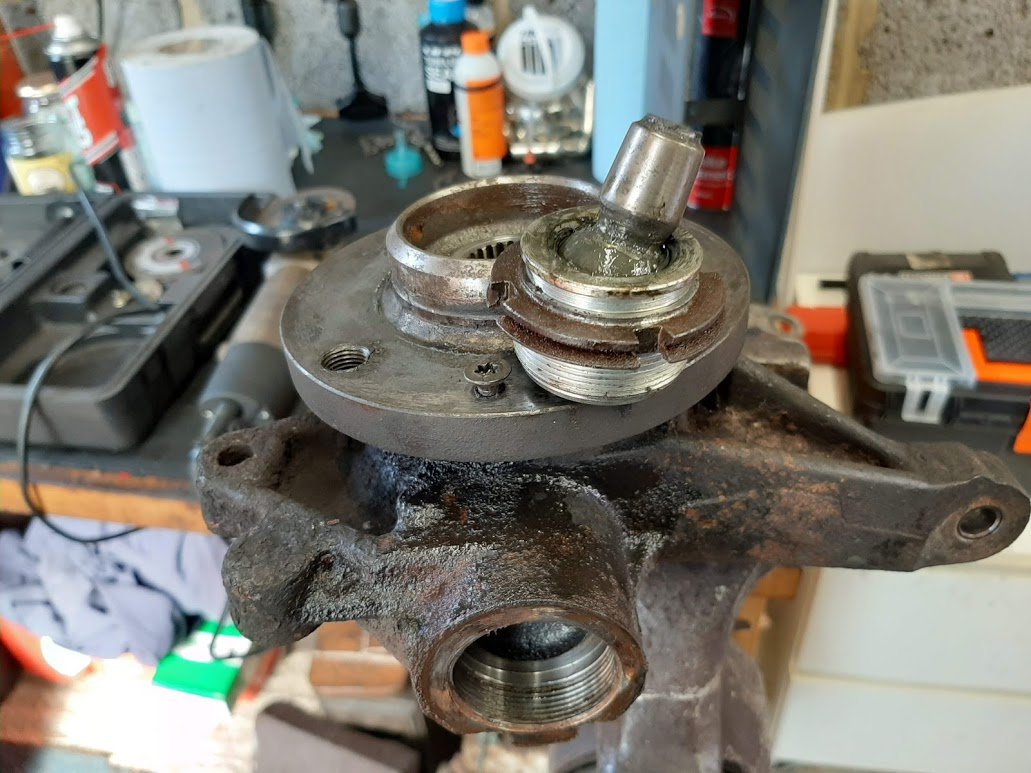

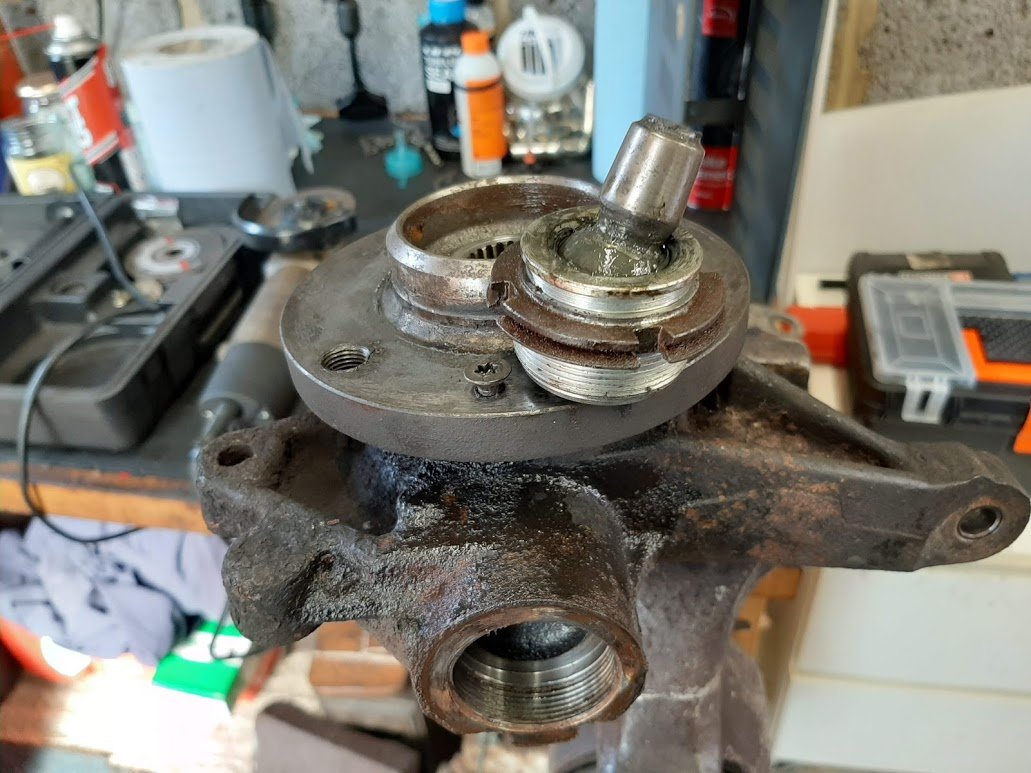

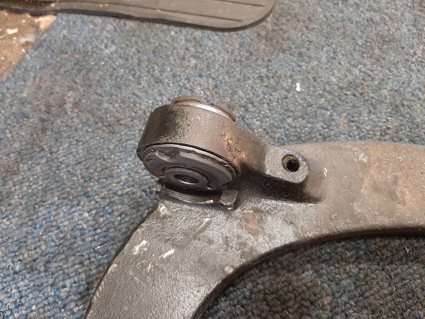

The day started well and after a good (virtual, due to the wet) bike ride I set about fitting new bushes to the wishbone. The front one fitted beautifully...
And so did the 'P' bush... Except despite consulting my 'template' (a scrap wishbone complete with bushes) I still managed to put the bush on the wrong way round
By the time I noticed my error it would not come off again and there was no hope of reusing it. I had to destructively remove it... Embarrassed or what...

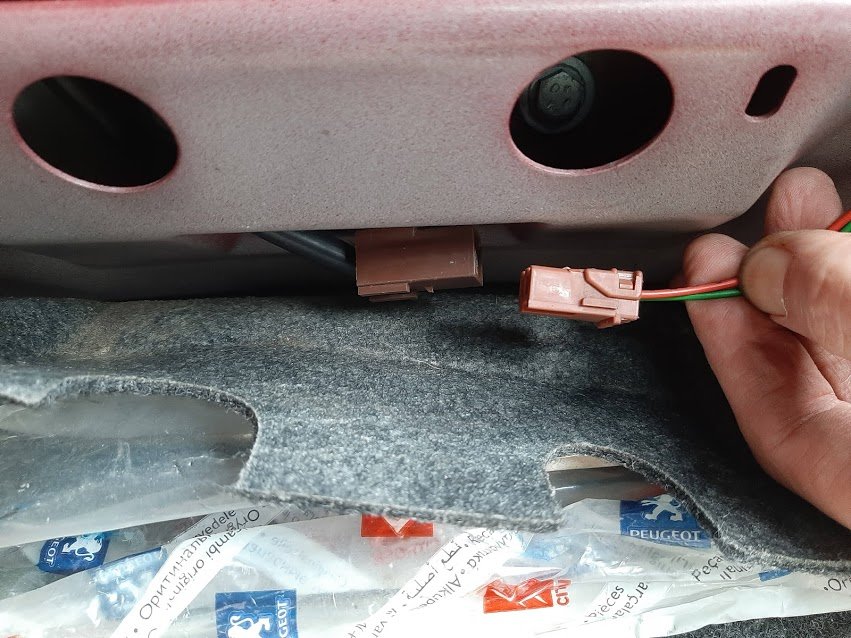

I did have one success today
The usual cause is the little switch on the tailgate catch (hasp) assembly failing... And indeed that was exactly what the problem was... The cure is to simply disconnect the switch at its connector under the plastic boot sill trim.
Job done...

Jim, give Paul (citroenxm) a call (after consulting with Zel, of course). On Gracie this switch had failed, and the alarm could not be set without then going off. Paul had a replacement switch for a few quid, and that sorted out the problem nicely. However, if he does not have one might this do (it is for a Xantia estate)?

Thanks JamesHell Razor5543 wrote: 28 Aug 2020, 18:51On Gracie this switch had failed, and the alarm could not be set without then going off.
It's not such a problem on an S1 Activa as the switch only controls the Hydractive system. It's known to be notoriously unreliable

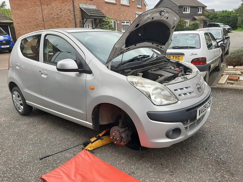

Pix, our little Nissan Pixo/Suzuki Alto, has received a little TLC today
New front tyres and windscreen wiper blades are needed and she might need inner CV joint gaiters too. I notice both seem to be weeping grease from their small ends but the gaiters themselves don't appear to be split. Odd... Like the securing bands have become loose.
The MoT is not due until December as she's subject to the Covid 6 month extension but I'll get her done early as I don't liker MoTs in the depths of winter in case some heavy spanner work is needed for a pass... I also don't want her MoT too close to Sally's so I'll aim for early October.

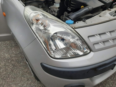

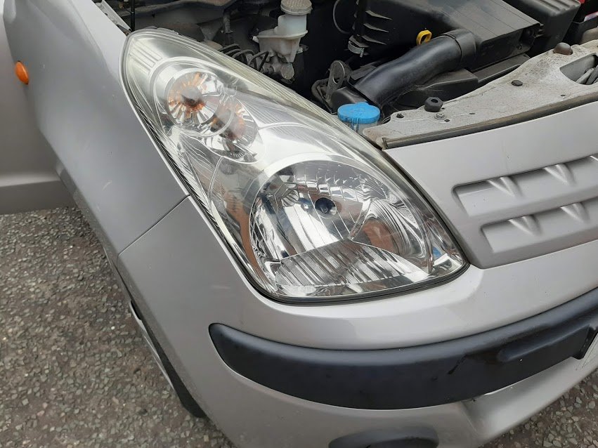

Last MoT she got an advisory for cloudy headlight lenses. This time a sure fail they were so bad but a good polish with Brasso wadding brought them up a treat

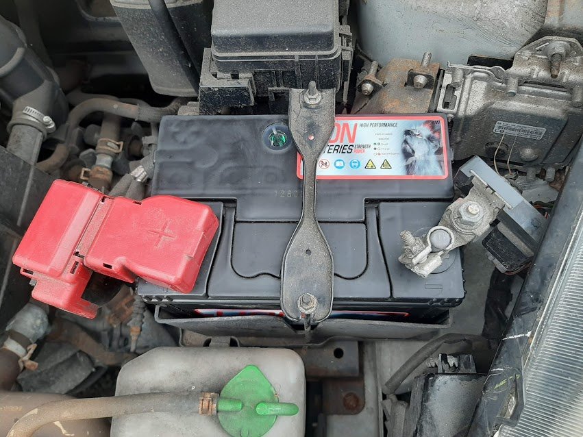

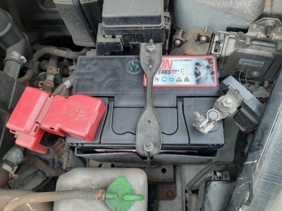

Finally, she got a new battery as her old one, 11 years old and original, was on borrowed time
Bet this ECP special bargain-basement job won't last 11 years! Is 11 years a record?
