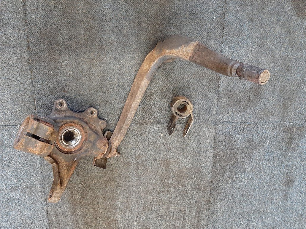

Zel's Activa... The adventure so far...
She failed her MoT a while back on a failed nearside suspension bush. Not the 'P' Bush but the front bush. Unsual.
The replacement of same is complicated by this being the Activa ram side...
After much to'ing and fro'ing to where the car was parked with my Saxo's battery in the boot of the Pixo I finally got the Activa relieved of her dead battery, started and driven to mine. Gosh! did it feel strange to drive an Activa after a Pixo and a Saxo
The first job was to remove the wishbone... Easy! undo the lower swivel joint, the Activa roll linkage and three more bolts and it will drop out in your hand...
If only... All came apart easily except the nut from the swivel... It would only undo almost a turn before locking up and spinning the taper in the housing
Never known such a thing... I tried every trick I knew but it was not having it at all...

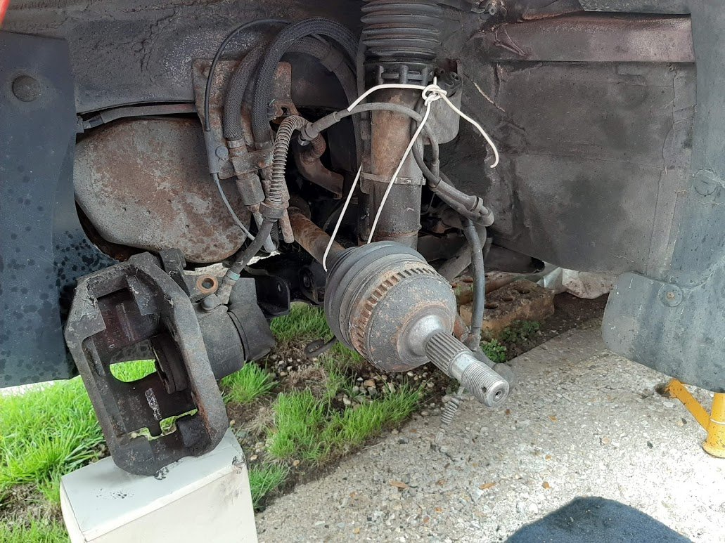

Only thing to do was to remove the wishbone complete with the hub!! This we did...
Everything else disassembled easily thanks to my liberal use of copper grease over the years... This was the result...

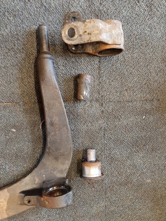

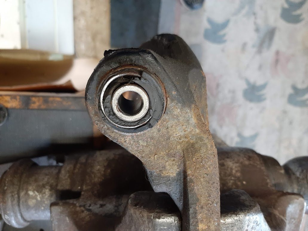

The 'P' bush was also found to be rubbish, it fell apart upon wishbone removal! This was missed by the MoT man!

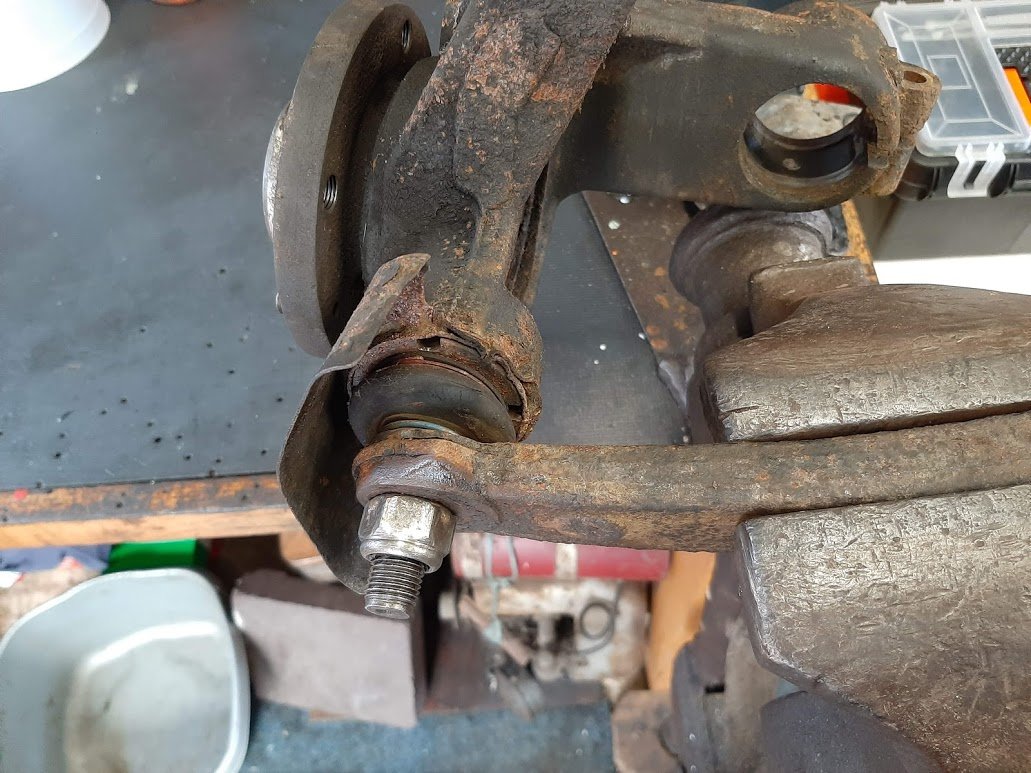

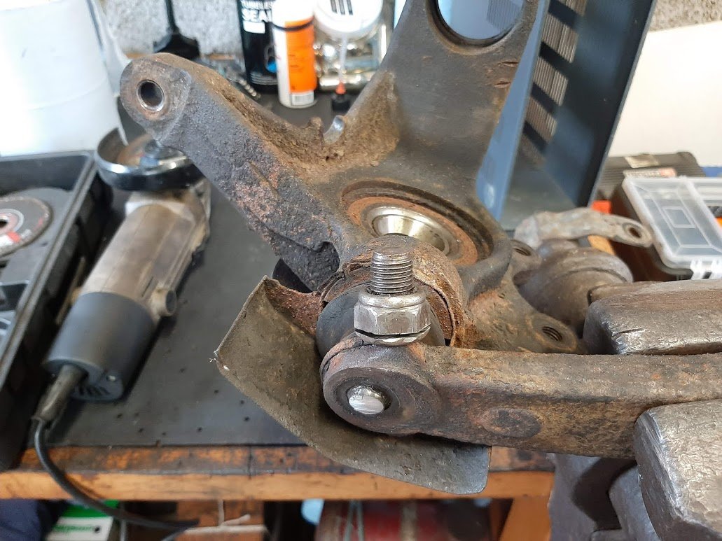

The next task was to separate the wishbone from the hub... Miss Angel Grinder please step forward
I cut through what I thought was about 7/8th of the nut and thread. I then took a cold chisel to it but even before the cold chisel make contact the nut and shaft declared defeat and promptly fell off... Zel and I got the giggles...

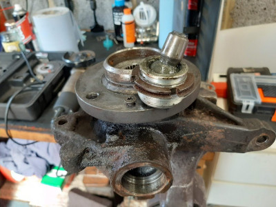

Then it was necessary to remove the remains of the lower swivel... Miss 5ft. Breaker Bar please step forward
The old front bush was truly gone!
Last job of the day was to remove the remains of the old 'P' Bush and front bush...
So now it's a case of fitting new bits, reassembly, new brake pads and a new MoT...

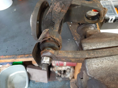

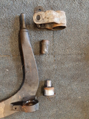

Nice work Jim, and looks like you sailed through the "problems" which cropped up. Looks like you have a fairly meaty vice there so the "removal of the remains of the swivel" with the aid of a five foot breaker bar didnt pull the vice off the bench, spin the hub in the jaws, or break the "castellated socket" which I presume you need to unscrew it.
Maybe you have been there before
- Posts: 55143
- x 8422
Re: Citrojim's Saxo and Cycling Tales
Many times Neil
That old vice is a blacksmiths's vice and is one of the best tools I have
