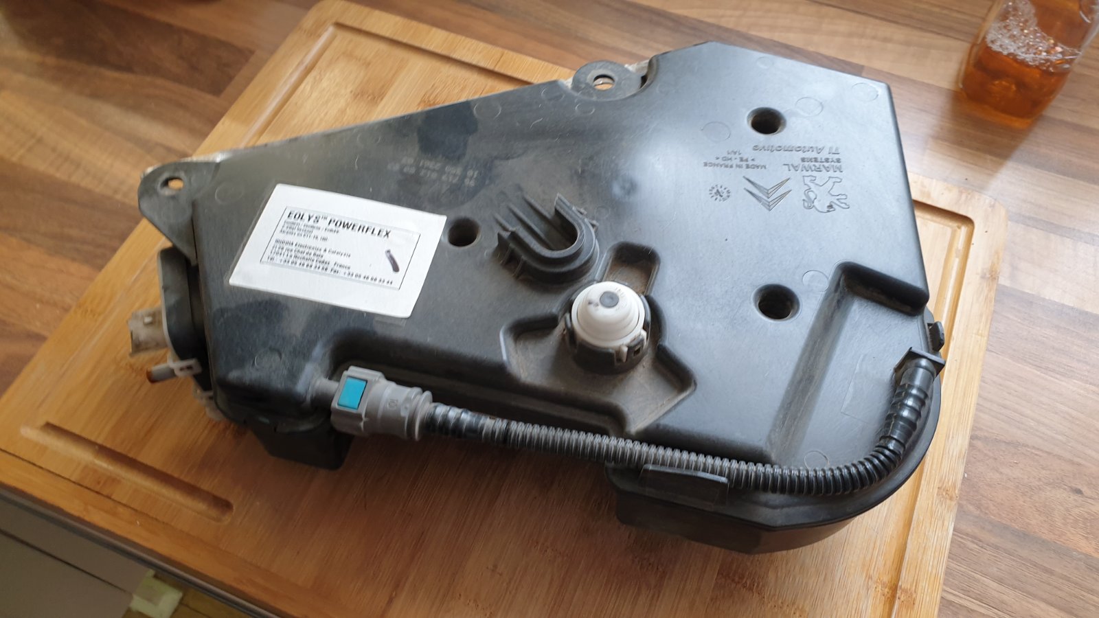

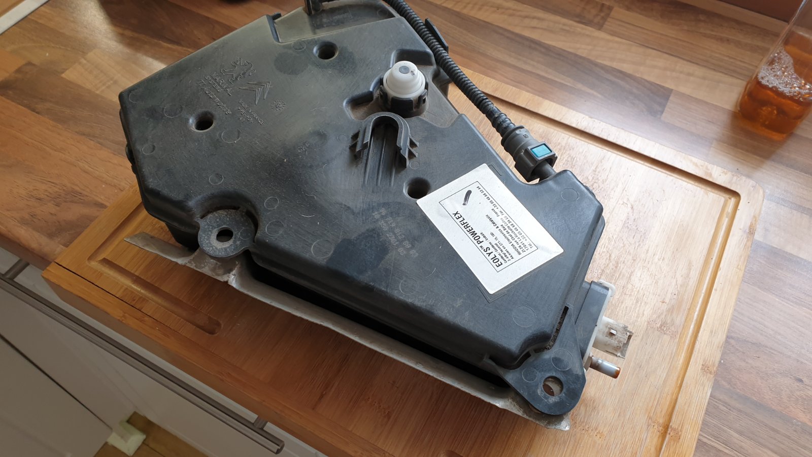

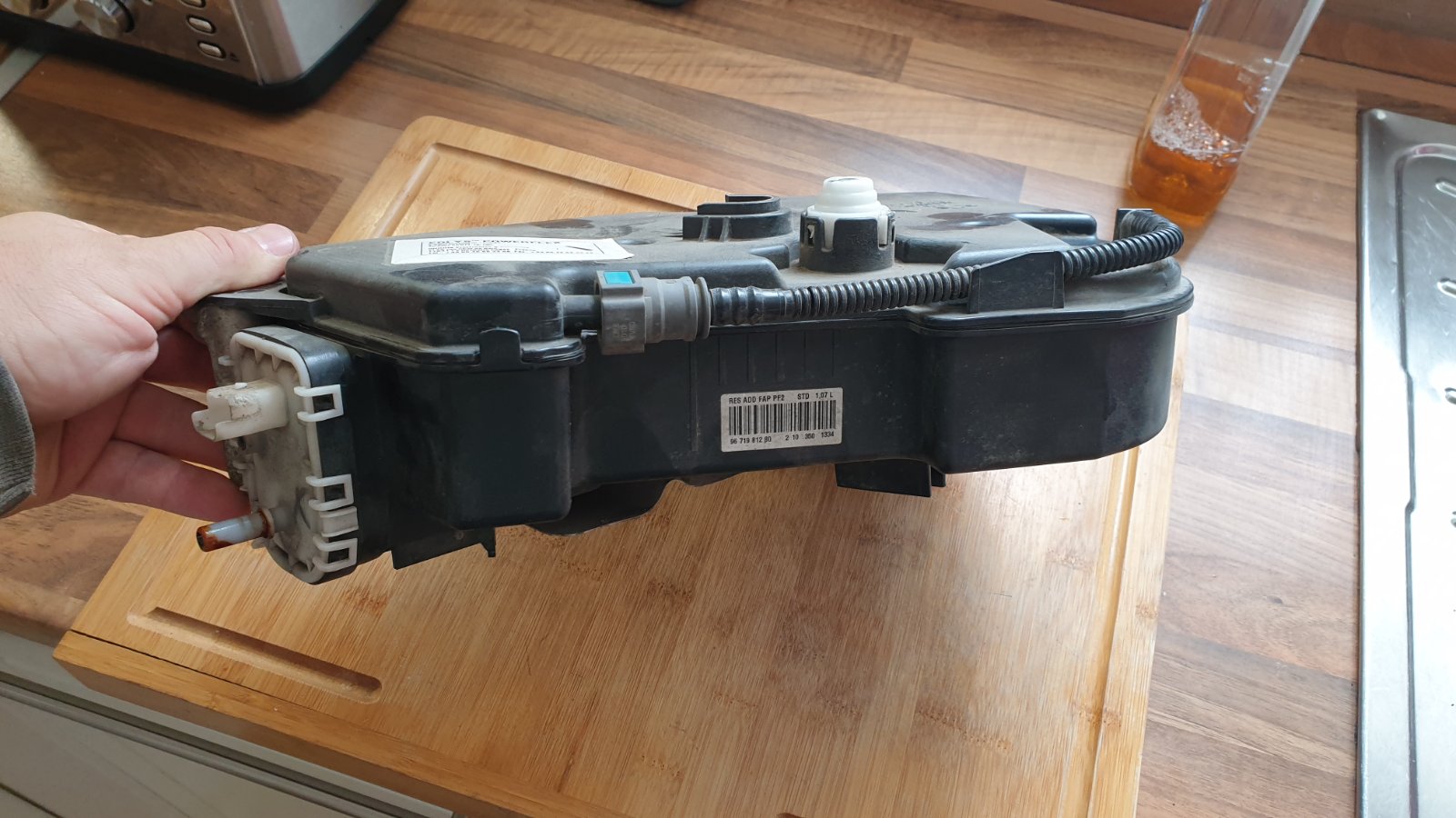

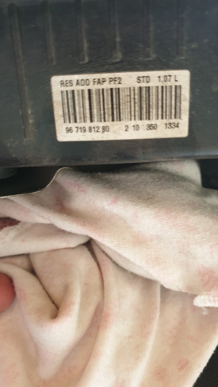

I have attached some photos of the tank i have removed i am pretty sure its the refill tank style not the pouch do you know if this is rightkoikidder wrote: 30 Aug 2020, 09:20 im going to have ago at removing the tank today i think its located passenger side rear? im going to have a look to see if i can get to it remove it and check the pouch if the pouch is ok i will order the filling kit a 2ltrs of fluid.
the only thing i dont get is i did reset it with my scan tool and it said successfully done but did not remove the warning message on the dash?
- x 6960
Re: 2010 1.6hdi 3008 additive level too low help needed
Yes, you have a reservoir on this vehicle.
The tanks are gravity-filled, so stick it back and use the kit to fill it. Don't be getting any of the additive on your skin - and keep it well away from sources of ignition.
