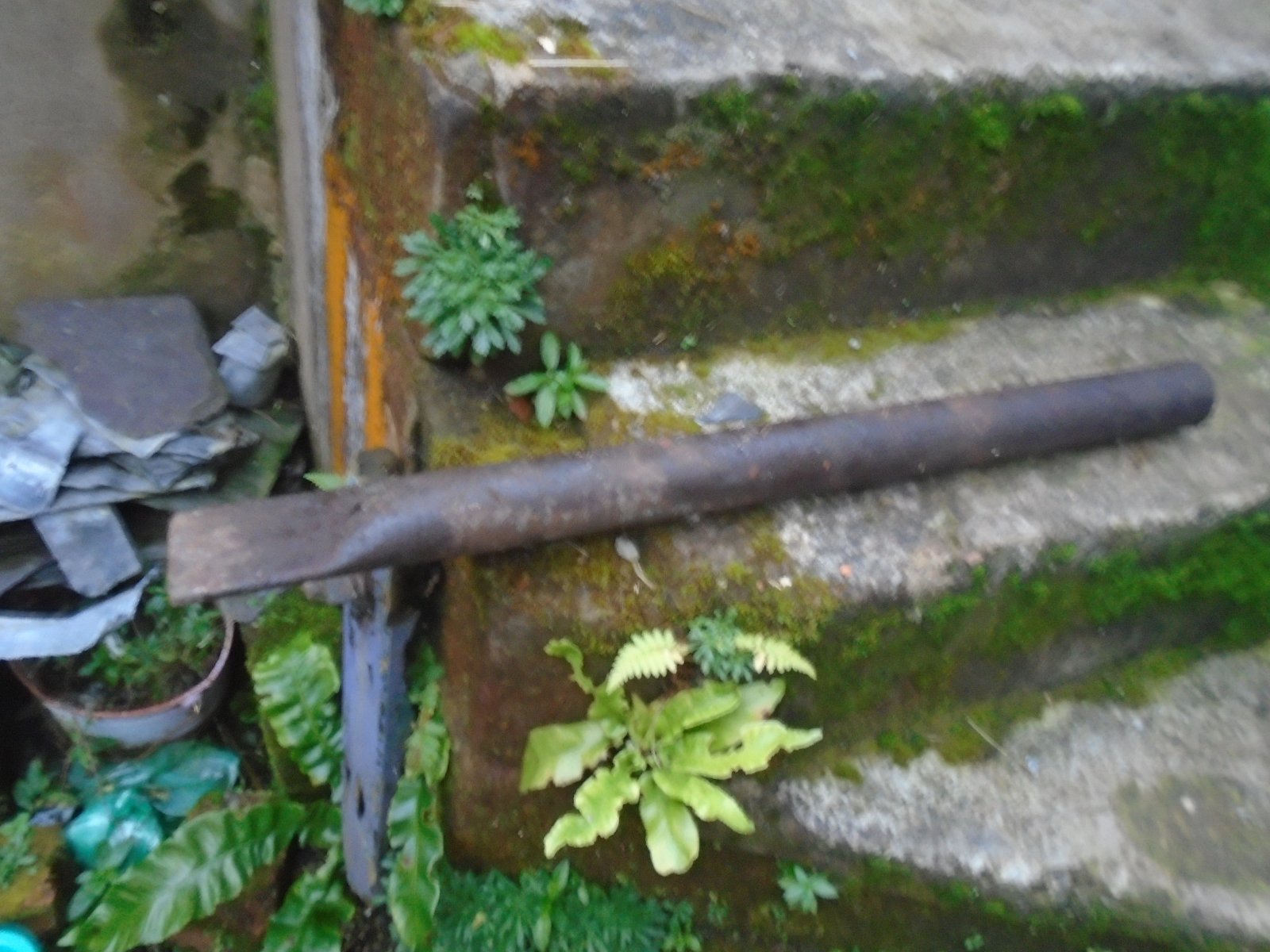

Return of the Sawn-off Scaffolding Pole......used on the bb micra job today here
NewcastleFalcon wrote: 22 Oct 2019, 20:48 I do hope everyone has one of these in their toolbag, 101 uses![]()
No idea where I got mine from, but it has a nice patina, one-end flattened, and I would say just the right length![]()

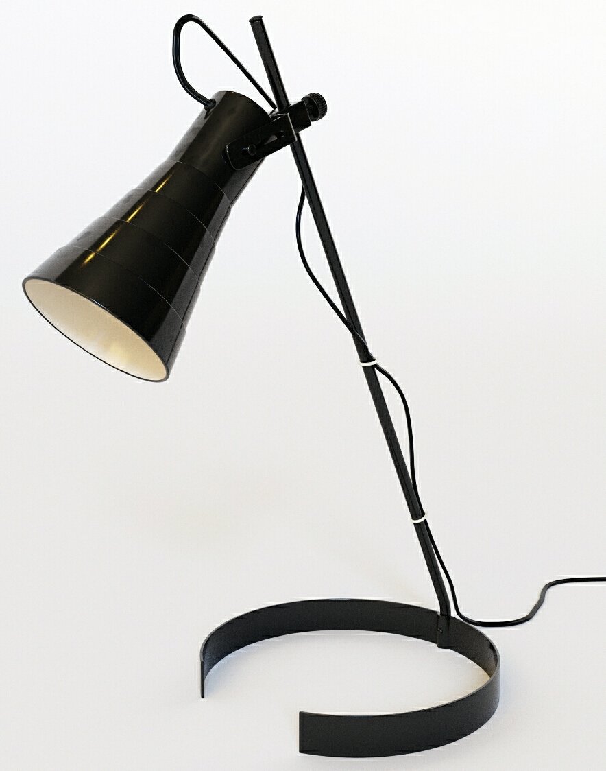

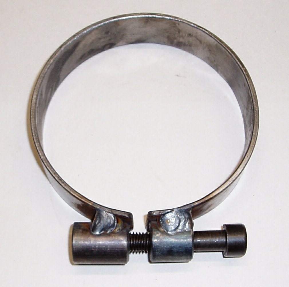

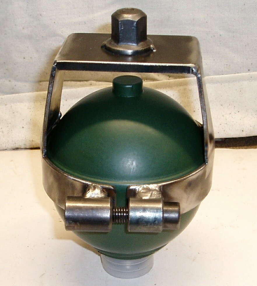

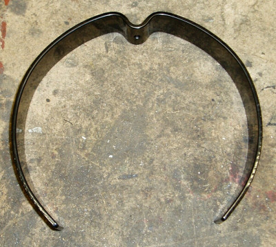

Having been directed to this thread by the esteemed Mr NewcastleFalcon, I thought it's an opportunity to share my Ikea sphere removal tool.
I wanted a light for my pillar drill, so I bought the cheapest desk lamp available at Ikea, the "Lagra", on special offer at a fiver.
The only bit I really needed was the lamp holder and swivel mechanism
Which left me with the base. Well, what can you do with a horseshoe-shaped piece of flat bar ?
- Posts: 21199
- x 8126
Re: Toolbag Tales-Homemade and improvised tools
Innovative thinking and great execution!! Love it!
