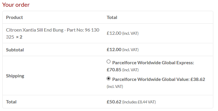

Took it to a local shop and the corner responsible for MOT failure is rotten both inside and outside, so needs some painting as well. Three other corners need fixing as well, with a hole behind front left tyre and rot elsewhere. It has been driven without mudguards on gravel roads, which didn't help. With all corners fixed + bottom cleaned and coated, it's going to cost between 800 and 1000 euros. With 141 thousand km on the odometer I think this Xantia will be on the road for quite a few more years. And now that I made the final decision to keep this for longer, it needs new spheres and brakes so down the rabbit hole we go. :D
Posts: 28673
x 5671
Re: Where have all the xantia posts gone?
The rot at the rear end of the sills is often caused by missing or distorted end plugs as mentioned here
Also many posts and pictures dealing with it in this blog. Read pages last ?first to find them.
jauv
Posts: 18
Joined: 11 Sep 2019, 15:16
x 12
Unread post by jauv »
myglaren wrote: 18 Aug 2020, 20:05 The rot at the rear end of the sills is often caused by missing or distorted end plugs as mentioned here
Thanks for the pointers - and it was indeed missing for an unknown period of time from the left side, which was worse off, and replaced with tape. The latter probably didn't help much. Right side plug is still intact.
Anyhow it will be opened up and replaced with fresh sheets of metal. The worst corner will be dealt with early next month, rest later as the garage is rather swamped currently. Goal is to do it properly without a rush.

Have a look at Xantia Sill End Bung i bought a couple for mine after i had a large water ingress :)

admiral51 wrote: 19 Aug 2020, 13:30 Have a look at Xantia Sill End Bung i bought a couple for mine after i had a large water ingress :)
Thanks for the link, however:
I'll figure it out - I actually have a glass fibre DIY plug, but I'm not entirely convinced it's waterproof - it's a very tight fit so probably OK with a gasget.

The sill bung (blanking plug) is still available from Citroen, under that pt.no. 96 130 325.
Any Cit/Peu parts counter should be able to supply.
