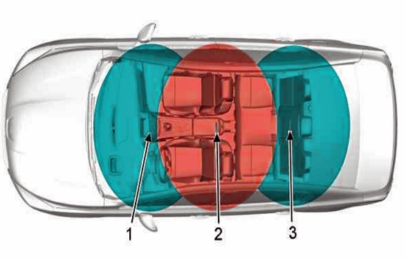

So as far as starting goes, there are 3 low frequency aerials on your 508. One in the boot area, one in the rear passenger compartment and one in the front passenger compartment:

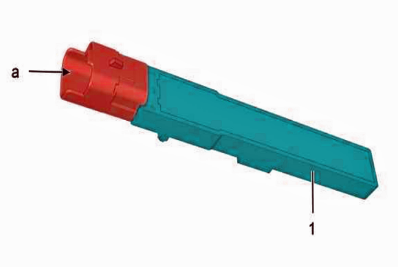

These are the low frequency aerials:
They have 2 pin connections - positive supply on pin 1 and earth on pin 2. They localise the hands free identifier inside the vehicle.
These are supplied by the main ADML ECU in the dash.
So I suspect that one of the aerial units nay be playing up / have a faulty connection, but if you don't have a warning coming up I would ignore it for now as you can still operate the vehicle.
I can't tell you exactly where the aerials are located unfortunately.
