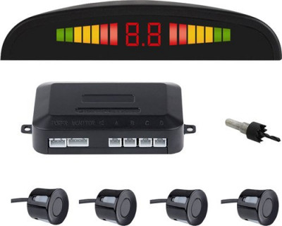

Can the problem also be caused by the battery? Because the vehicle is connected to LPG, parking sensor is connected, rear view camera is connected,double din car is connected (KAWA? KW-3500 BLUETOOTH/USB/AUX/SD 7")

Was everything working after you fitted that aftermarket radio system and were the parking sensors also non-standard? I have assumed (maybe wrongly so) that everything has been working previously and that the overheating warning / fan issue is only a recent issue? Or have the problems only started after you fitted the radio / parking sensors etc?

first, the parking sensor is installed in the vehicle. then the radio system was installed. The last reversing camera was installed. I drove 1700 miles before installing the reversing camera. But there was no fan problem.

And I've also checked the wiring - although the C3 has bulb out warnings, there is no CAN wiring to the light clusters (in case the aftermarket parking sensors were a concern and wired into the reversing light wires).
