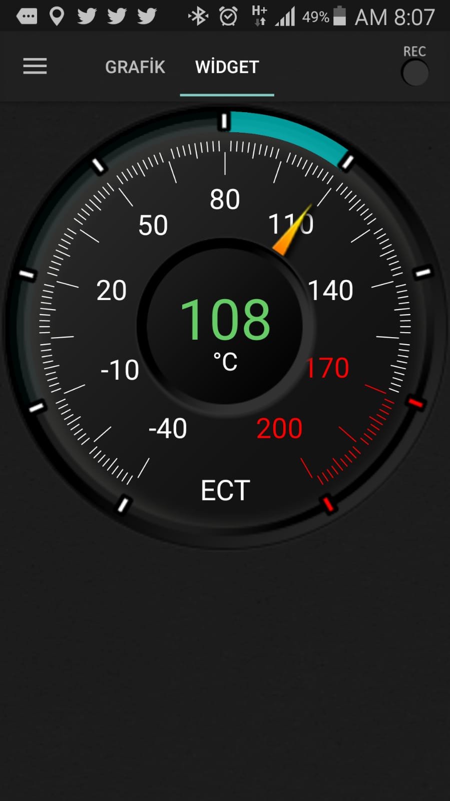

Yesterday I wanted to buy a water temperature sensor. However, he did not sell genuine parts and said they were counterfeit products. That's not why I did it.
Ayr?ca bugün OBD cihaz?yla da gözlemledim. Fan ilk a?amada 97 derecede (Yava?) çal??t?. Orijinal bir su s?cakl??? sensörünü bulmaya çal??mam gerekiyor gibi.
[Translation added by GiveMeABreak]
The temperature then exceeded 100 degrees, but the second stage of the fan did not work. I don't understand the source of the problem.I also observed with the OBD device today. The fan worked in the first stage at 97 degrees (Slow). Looks like I need to try to find an original water temperature sensor.
