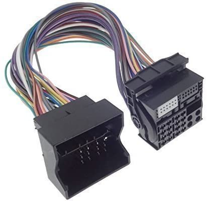

I dont know your specific system well but I know in the past cars with built in satnav & audio amplifiers were a bit of a nightmare when it came to installing handsfree kits they usually needed a specific adaptor or sometimes it wasn't possible & required an external speaker, you always needed to check for these things before ordering the harness.
One piece of valuable advice I will chip in is if you do decide to give it a try is do not butcher any of the cars original wiring whatsoever. Instead get a fully populated quadlock lead like the one below & make an adaptor harness to suit it, that way if it doesent work or you need to go back to original it will just slot straight back in & it wont look like a car crash behind the radio.

Re: C4II Stock radio panel change
I made adaptor-cable for Match M5DSP using one of those extension cables. I just had to cut speaker cables on that adaptor and join the output from MyWay to Match M5DSP input and output to speakers to Match M5DSP output. Easy soldering job to join 2x8 cables.
