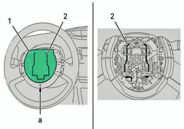

Insert a large flat screwdriver in the orifice " a". Push on the pin (2) by means of a screwdriver. Unclip the airbag (1). Disconnect the airbag (1). Remove the airbag (1). Be cautious when storing an operational airbag! Refitting N.B.: Observe the precautions to be taken. Reconnect the airbag. Clip the airbag (1) on the steering wheel. |

| CAUTION: Fit the tool [ 1] before removing the fixed centred controls steering wheel. Clip the tool [1] on the fixed centred controls steering wheel (at "c"). | Remove:
