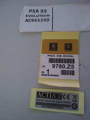

Re: diagbox/lexia
Post by citroen7 »
Pic
Pic
Pic
Pic

Re: diagbox/lexia
Post by GiveMeABreak »
That doesn't tell me the name of the software and it's version. Is this Diagbox V8 by any chance?
If so, I would forget that if this is for your 2006 C5s. Diagbox V7 will do everything you need. Install up to V7.58 and leave it there - that will cover vehicles up to November 2014 - As it will be launching Lexia anyway, you'll get no benefit whatsoever from installing Diagbox V8 unless you have vehicles from 2016 onwards.

Re: diagbox/lexia
These look like old versions and I can't tell you whether they have been 'modified' to work with cloned Actia interfaces.
If this is an old non-full chip Actia clone unit, you may be restricted to the earliest Diagbox Version 7.02 as it may not work with later software versions. I can't help you with installing these standalone versions as Diagbox 7.0 doesn't have that request.
I would suggest trying to get hold of Diagbox V7 and installing that using the general install instructions out there on the web and allow it to restart after installation and it should be activated at V7.02. Leave it at that and then try it out. It may giove you a choice of Lexia or Diagbox for your C5
