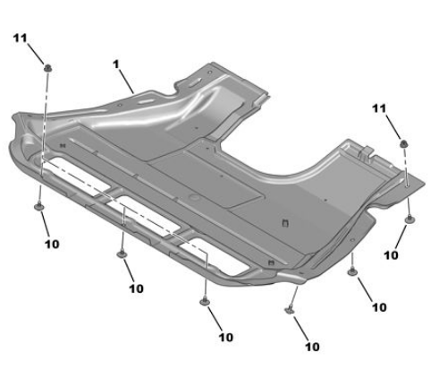

Hi Julian - I'm not quite understanding what you are referring to. If it's the under tray engine protection for your C8 as follows and that is a single part:
Most have this protection, but I can't see any other obvious air channels or deflectors. The covers are completely different for other models too.
The only reason for the depression on the one side of the engine protection I can see is to allow for the shape of the flexible bush as it's only on that one side.

I can quite understand why you can’t understand from that picture ! Mine looks quite a bit different from that.
I’ll try to post a picture tomorrow but on mine there is rigid rectangular plastic tube that ducts air from the left hand front of the car across under the engine and ends up in a slightly smaller diameter almost ‘jet‘ directed right at that mounting.
It is definitely a factory fitment - I’ve known the car from brand new and it’s an ex-Citroen UK press car - probably the first in the country.
I just wonder if they did this because they knew it needed to be kept cool to prevent it softening ??

Here are some pics of the undertray. Ignore the silvery pads, that’s what I fitted about 100,000 miles ago to replace the original flimsy felt like sound insulation that was disintegrating !

Ok, I've got it now with those new pictures.
Basically it's an air deflector that's located on the engine cooling system. Part 11 is connected to the front cooling fan housing and then goes into that flat tube that is shown greyed out. I have not had any luck identifying the part number for it - so can only assume it is incorporated into the under engine protection cover, despite it not being show on that diagram (to avoid any confusion perhaps).
