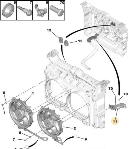

Finally, this is a pic of where that air comes from.
I’ve just realised that that goes up behind one of the main fans which, of course, are on all/most ? of the time the air con is on so it blasts air at that mounting 😳
Julian Leyton (RIP) 2023
x 6954
Re: 2.2 HDi torque reaction mount
Ok, I've got it now with those new pictures.
Basically it's an air deflector that's located on the engine cooling system. Part 11 is connected to the front cooling fan housing and then goes into that flat tube that is shown greyed out. I have not had any luck identifying the part number for it - so can only assume it is incorporated into the under engine protection cover, despite it not being show on that diagram (to avoid any confusion perhaps).

Thanks again Marc and yes, it’s plastic welded into the undertray.
You know how powerful those fans are and I’m wondering whether, because I quite often have the air con turned off (but use it at least once a month) I’ve just not been allowing enough air through to cool that mount ?
Still be interested to know if C5 / C6 use similar and, if not, why on earth would it be just on C8 ?
x 6954
I've just confirmed that item (11) is not found on any other vehicle - apart from the Peugeot 807 with the same engine as these are essentially the same vehicles.
The only thing I can think of it that as it is specific to this engine, but ONLY as fitted on the C8 and 807, then it must be to do with the mounting position / angle / space / location on these vehicles that makes it a requirement.
The same engine on the X7 with similar twin cooling fans does not have this part - but the X7 generally has oodles of room under the bonnet.
I would suggest that this may be supported by the fact that the engine mountings are completely different too.
