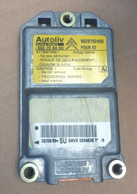

On a Xantia I had the side impact ECU (L/H) had failed. Replacing it cleared the fault. I am NOT saying this was the same problem as yours, but it is something to be aware of.

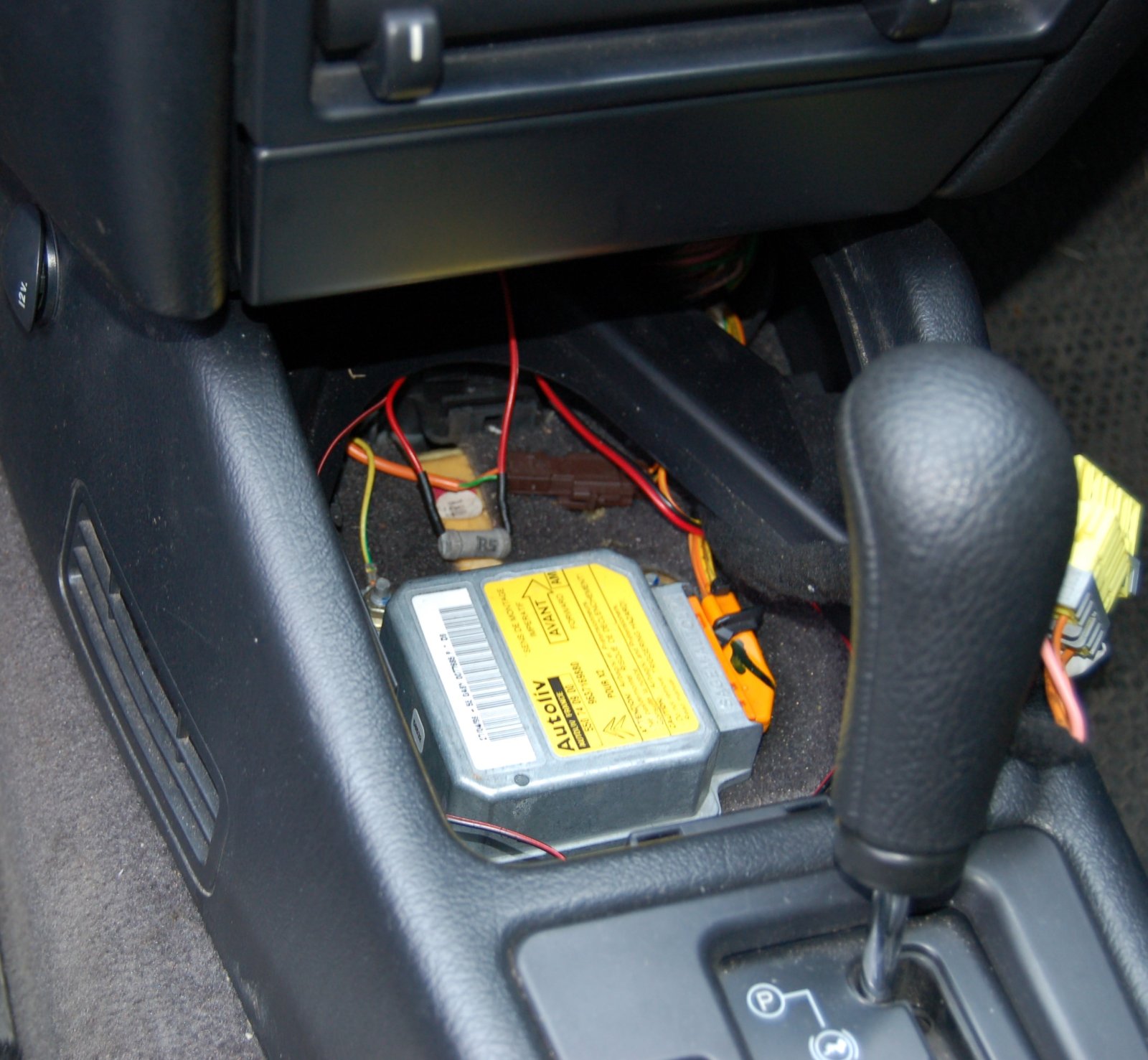

Thanks guys, VIN is VF7**************[VIN obfuscated, can be read by forum staff] - it's a Sept '99 2.0i Exclusive Auto Estate - I think it just has the two front airbags, plus side airbags in the front seats.
re. ECU, presumably it is is just the main centre ECU module below the centre console?

- Posts: 10973
- Joined: 09 Nov 2005, 22:03
- x 1459
Re: Xantia side airbag warning light
There are also side airbag ECU/trigger units, one inside each 'B' pillar, they are accessed after removing the front seat belt reel.

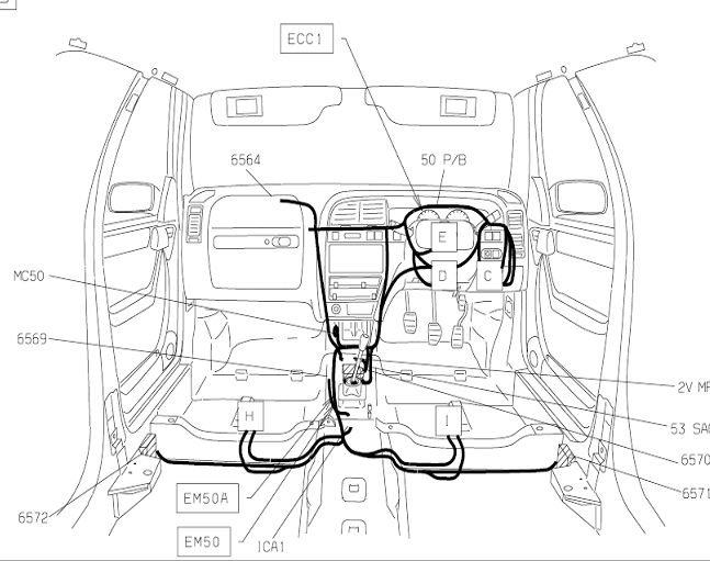

Here's the Airbag Circuit for your Xantia with your specific options / fittings.
Most Equipment Codes can be found in numerical order on our Wiki here:
https://frenchcarforum.co.uk/wiki/Elect ... ring_Codes
Here is a physical layout of some of the harnesses:

Good news problem solved - it was indeed the RH side-airbag trigger module - managed to pick up a good second hand unit from a 2001 model Xantia. Tempted to look inside my faulty original unit, see if anything looks wrong, my suspicion is a dry joint maybe? Thanks again for all assistance with this.
