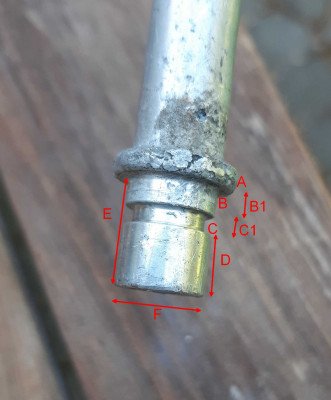

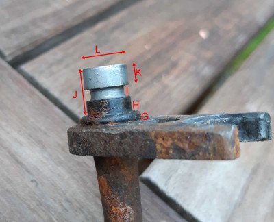

As per Chris's reply the sizes you require are 8mm x 2mm and 9mm x 2mm. These are internal diameter and width.
A: Swage Dia 16.70mm
B: Pipe Dia (same as F) 11.95mm
B1: Section Length 3.30mm
C: 'O' Ring Groove Dia 9.45mm
C1: 'O' Ring Groove Width 2.45mm
D: Section Length 8.60mm
E: Overall Length to Base of Swage 14.00mm
G: Swage Dia 14.90mm
H: Section Length 3.70mm
I: 'O' Ring Groove Dia 8.30mm
I: 'O' Ring Groove Width 2.78mm
J: Overall Length to Base of Swage 11.58mm
K: Section Length 5.10mm
L: Pipe Dia 10.95mm
Thanks must go to Bobbins for these measurements.
A to E is the Aluminium Pipe and G to L is the Steel Pipe.
Kenny
L: Pipe Dia 10.95mm
Kenny

Just one question , what ShA and FDA do i chose, or is this trail and error
- x 1750
Re: Hydraulic repair failed on steering
ShA (shore hardness) of 75 will be ok, Viton (FKM) quality.
I suggest ordering the next small increase in thickness as well as 2mm.
PSA are known to be not very generous with OE O-ring sizes, and a fraction of a mm oversize might be needed to get a really snug fit.
Cheap enough, and avoids need for a second order.
Lubricate with silicone grease/vaseline as you fit, to prevent scuffing.
