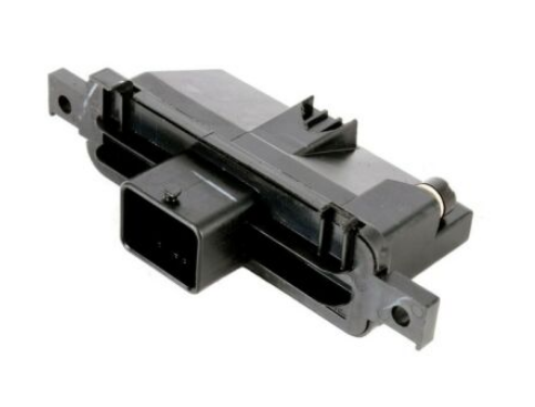

Does anyone know where directional headlamp ECU is located on a 2006 C4 VTS? I have the "no connection to directional headlamp ECU" fault but can't find the ECU anywhere.

The headlamp adjustment ECU location is near the left hand wheel arch are of the engine bay.

I have offline servicebox, but I can only find a vague display of the ECU and can't find it mentioned in the workshop manuals. I'll try to trace wiring back to it.
x 6957
Re: C4 I directional headlamp ECU
Not very good, but it should be near to the left side of the fusebox - I've arrowed it - item 6606.

Found it, under(above) the wheel liner.
All is well, all connections are fine.
Thing is, that ECU is greyed out in the Diagbox. Can it be re-paired to the car? Resynchronised or whatever it's called.
