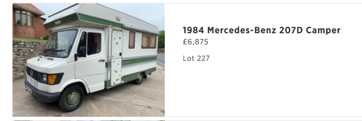

The 207D I mentioned earlier Zel sold for £6,875 inc buyers commission

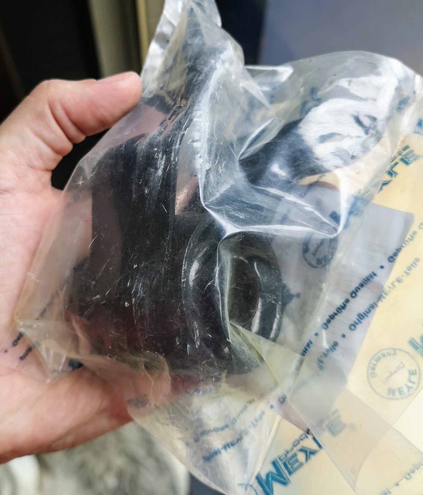

*Finally* have this in my hands.
Rear left hand lower control arm bush for the Xantia.
Before I throw this at a garage to fit, is it actually as easy as it looks like it might be? Jack car up, support control arm, undo boots, slip off old bush, replace with new one, reverse removal? Or is it pressed into the control arm or something like that?
Planning to just let my trusted garage deal with it, but if it's really simple I might give it a go.

CitroJim wrote: 19 Oct 2011, 21:50 Getting the old 'P' bushes off can be fun.
The best way is to lay the wishbone o the ground, hold it under foot and drive the old bush off with a cold chisel and biiiig hammer. If this fails then carefully cut away the outer and very carefully angel grind the inner sleeve lengthways until it can be split off. be careful not to nick the underlying wishbone...
Clean the shaft of the wishbone until it is spotless, oil it lightly and after confirming alignment very carefully, drive the new 'P' bush home. Use a socket as a mandrel for the last few mm.
Adam, good point about final tightens once Citarobics have been done...

Nope, nope, nope, nope nope...The garage can have that fun.xantia_v6 wrote: 27 Jul 2020, 19:55CitroJim wrote: 19 Oct 2011, 21:50 Getting the old 'P' bushes off can be fun.

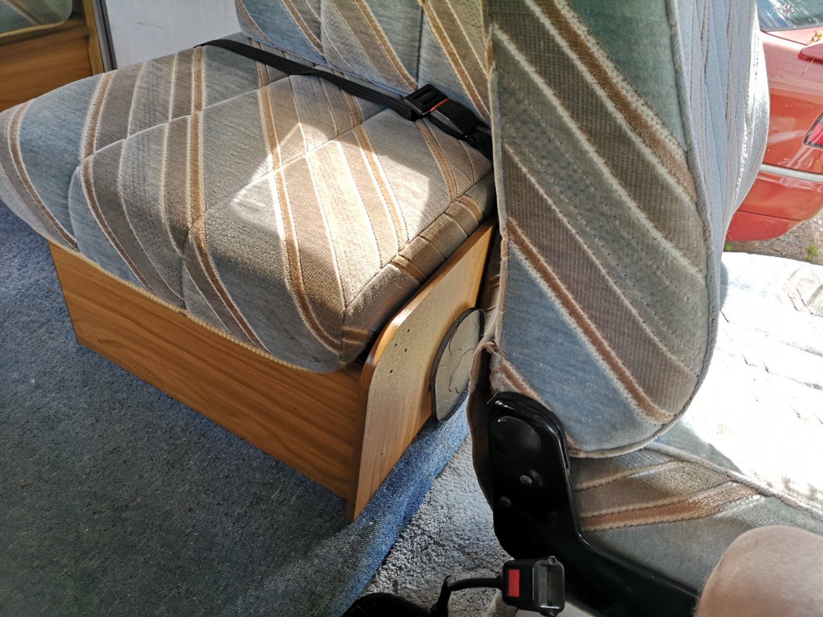

You should be able to re-carpet that. Not a complex shape: sides first, then a final piece for the top, tucked in so the 'join' doesn't show.
No end of choice, including a good shag pile.

Re: Zel's Fleet Blog - Xantia Activa, Jag XJ-S, Sinclair C5, Mercedes 208D, AC Model 70.
Being totally honest I'd actually prefer if it was uncarpeted. The base tends to get scuffed quite a bit when you're climbing through the cab to get into the back and the offside of it gets a lot of wear by the clutch.white exec wrote: 28 Jul 2020, 18:27 You should be able to re-carpet that. Not a complex shape: sides first, then a final piece for the top, tucked in so the 'join' doesn't show.
The shag pile in the cab looks really out of place to me, and being a light colour in the cab of a van is a nightmare. I'd far prefer something like a dark grey or blue cord carpet in the cab.
What I'll probably go with though is more of a mid blue to match the carpet already in the back.
That's actually got a couple of areas where it's quite worn so might be a good time to just lay new carpet through the whole cabin.
