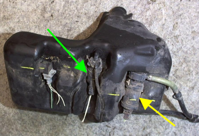

Here is a picture of the reservoir:
The headlamp washer pump is shown in yellow and the windscreen pump is shown in green. So you probably have a faulty windscreen pump. The service diagrams are confusing as they show only each pump separately and not combined. The larger pump in yellow for the headlamp washers is larger as it needs to supply the washer jet accumulator rams with much higher pressure.
So I would focus on the windscreen washer pump in the middle - which has probably failed.
