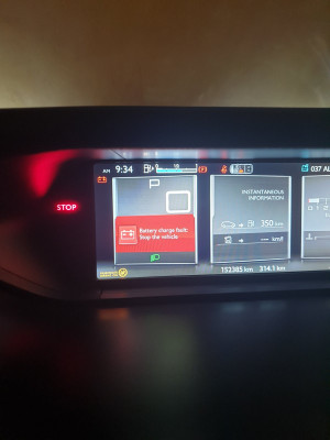

Hi
I noticed that everyday in the morning an error message appears says '' Battery Charge Fault: stop the vehicle.
This message appears only in the morning after leaving the car all the night but all the day nothing appear this message appears for a while and then gone after moving with the car the service center checked the battery and the Alternator and the charging is good for both also as you know the C4 Grand picasso no way to leave anything powered after power off the engine so any idea what could cause that problem.

There is a known issue with this model concerning the drive belt tensioner rollers. This could be affecting the charging of the battery. Do you have any noise from the belt or the rollers? It may be sporadic, but the recommendation is to replace the rollers and the belt with the replacement parts - if this is the issue of course.
The warning to stop the car is because it thinks the battery charge is low and this can affect the handbrake - on this model it will not apply the handbrake if the battery is too low, otherwise you wouldn't be able to release it. So they recommend stopping and immobilising with chocks on the wheels whilst you have this issue.
