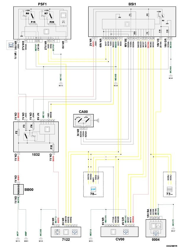

wheeler
Posts: 7930
Joined: 21 Sep 2002, 19:07
x 1055
Re: C4 VTR power steering issue
Unread post by wheeler »
Doesn't look to much to it.
Battery live & earth on the 2 pin black & ignition live on pin 1 of the 5 way black. The other 2 wires are CAN lines.

wheeler wrote: 18 Jul 2020, 18:54 Doesn't look to much to it.
That’s brilliant thank you for your help, much appreciated.

A little update. Checked the wiring at the power steering pump. Pin 1 is a blue wire, checked and no ignition fees down this wire. I do however have an ignition feed down pin 5 which is a red wire which does not seem to correspond to the diagram.
x 6945
That's not the correct diagram for your C4.
Pop your VIN up AF1 and I'll get the right one up, Wheeler has used the later C4 not the earlier model.

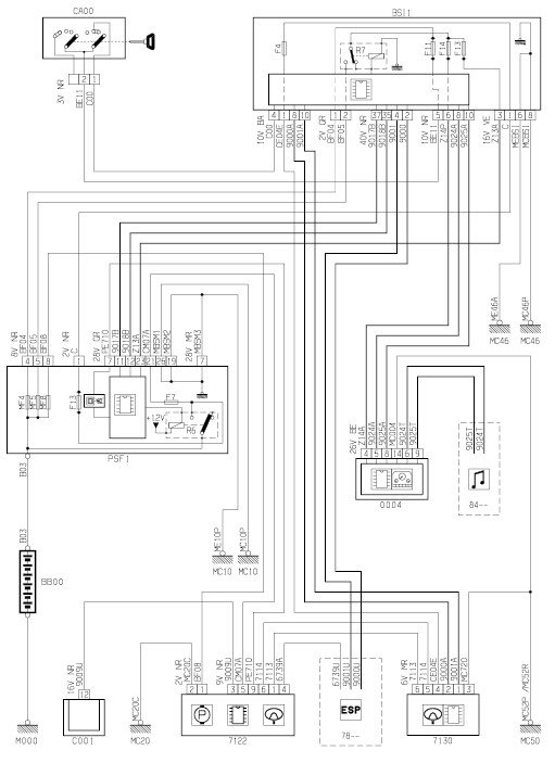

wheeler
Posts: 7930
x 1055
My bad, i should have noticed it was a newer style diagram. This one should be correct & ties up with what you are getting.
