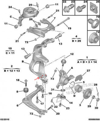

Dear all, could someone offer me some advice? I've been having a recurring 'knocking' problem on my front suspension - C5 X7 2009 Exclusive Tourer.
In November 2019 the car went into my local Citroën specialist to have a number of parts replaced including both lower balljoints, and a failed n/s hub bush. On collecting the car the worst of the knocking had been cured but there was still an occasional muted clunk during certain manoeuvres. Gradually the sound (and the feeling through the floor) became more pronounced and in February I took it back to the garage and asked them to investigate. They said that they had tightened one of the balljoints up and cleaned around the anti-rollbar links - this temporarily improved things and the noise was still there.
COVID then hit so the car was little used for 3 months but the problem persisted and worsened. I took to back to them in June and (although they never seemed to think there was a problem with it) they re-tightened things again. The car was MOT'd at this point.

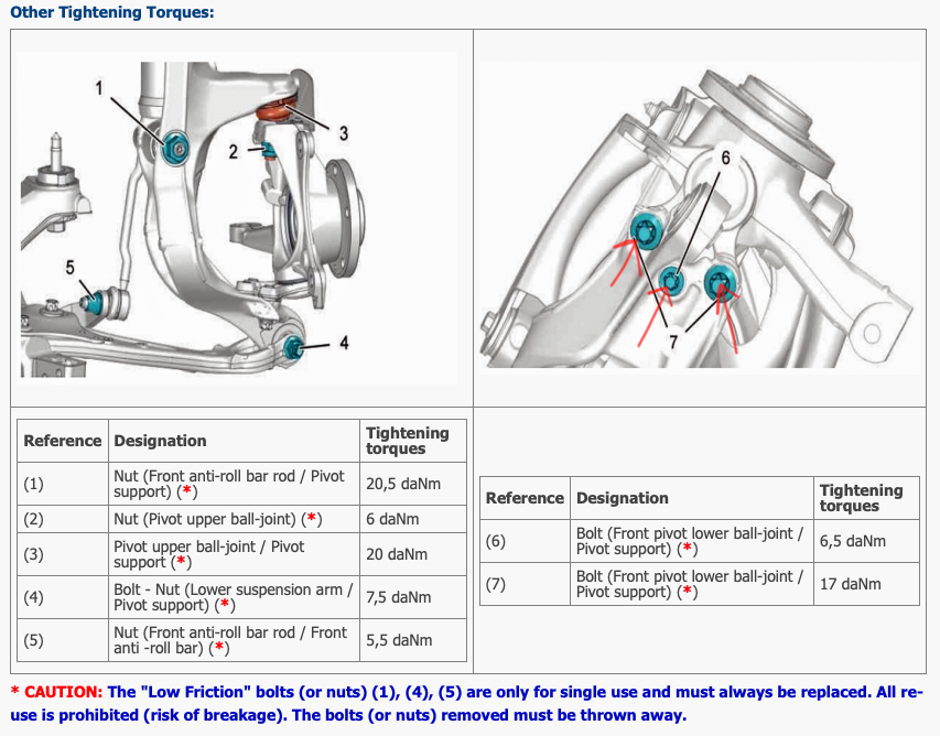

In the subsequent weeks (I'm still furloughed from work so the miles being travelled are very small) the noise got progressively worse so I dropped it into a local garage who immediately pointed out that there was a problem with the point where the balljoint is attached to the pivot support/strut support (not sure of the correct term?). The bolts have been moving in the holes and elongated them and now it's impossible to tighten them enough to stop the movement, the wheel can be waggled by hand when jacked up, and my local garage were amazed that it recently passed its MOT. It now looks like the whole support needs replacing.
The bolts/locations in question are highlighted by red arrows (not THE Red Arrows I hasted to add) on the attached pictures.
Has anyone had a similar problem?
Can anyone advise me of the correct part name and number of the support part, and/or offer any advice on how best to proceed? I have access to Servicebox but of course now I can't access the diagrams - the attached are ones I found online).

Looking at the diagram (both here and in my local copy of DocBackup) I think you are looking at item B. I am trying to find an official name for this part, but no luck so far.

If the lower pivot occasionally clunks when braking or when taking off on occasion or sometimes going over a bump then it's likely to be the same issue.
If you look at the diagram on my post I have highlighted in yellow the horizontal movement of the bush indicated by the red arrows above when it is fitted in place. When the bush wears, the momentum of braking and starting move the lower pivot support (B) in the wishbone highlighted in yellow and this makes the occasional clunk.
Citroen don't sell the bush alone of course, but it can be bought easily on the aftermarket and fitted by your local mechanic.
viewtopic.php?p=644727#p644727

Yes it is part B. Images of it come up when I search for Strut Support or Support Pivot but I don't know the official name for it.Hell Razor5543 wrote: 12 Jul 2020, 11:16 Looking at the diagram (both here and in my local copy of DocBackup) I think you are looking at item B. I am trying to find an official name for this part, but no luck so far.

Yes it does happen under those stresses but it's definitely play in one or more of the three holes in the lower part of that large vertical component. I saw the front bolt moving in the socket when the mechanic waggled the wheel. While driving the wheel makes a twittering sound which is the bolt rattling around in the hole.GiveMeABreak wrote: 12 Jul 2020, 11:24 See my post here:

It's called the Front Pivot Support and it's the lower bush you want, unless you are looking to replace the whole support. See my link in the other thread for a link to a supplier of the heavy duty replacement bushes.Scorchy wrote: 12 Jul 2020, 11:32Yes it is part B. Images of it come up when I search for Strut Support or Support Pivot but I don't know the official name for it.Hell Razor5543 wrote: 12 Jul 2020, 11:16 Looking at the diagram (both here and in my local copy of DocBackup) I think you are looking at item B. I am trying to find an official name for this part, but no luck so far.

Based on what the OP has said I think the holes in the lower part of the support (item B) have been worn so that they are no longer round, and parts that are secured through these holes can now move in ways they were not designed to. It seems likely to me that the whole support will need to be replaced (with something like the ebay item I posted up).GiveMeABreak wrote: 12 Jul 2020, 11:40It's called the Front Pivot Support and it's the lower bush you want, unless you are looking to replace the whole support. See my link in the other thread for a link to a supplier of the heavy duty replacement bushes.Scorchy wrote: 12 Jul 2020, 11:32Yes it is part B. Images of it come up when I search for Strut Support or Support Pivot but I don't know the official name for it.Hell Razor5543 wrote: 12 Jul 2020, 11:16 Looking at the diagram (both here and in my local copy of DocBackup) I think you are looking at item B. I am trying to find an official name for this part, but no luck so far.
