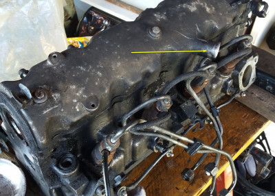

Not the greatest way of viewing pix that, I prefer Dropbox; but from what I can make out I think maybe you're referring to
1: the Hose connection I've arrowed on one of my spare Cylinder Heads, this is just a Breather Hose and it should have a clip on it, but if it hasn't the simplest thing you can do is either open up a Jubilee or tie a Cable Tie around it, that'll avoid you having to take it off; but its probably not horribly insecure as it is.... and if the mechanic did indeed do a Water Pump its unlikely he undid this, so its likely been like it for some while.
