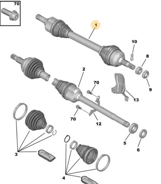

Can anyone assist in helping me identifying the driveshaft on my C5. There are no labels on the shafts as mentioned in the workshop manual. So can this be found by VIN? Which is VF7**************[VIN obfuscated, can be read by forum staff]

Good point. Its Left hand side. The threads got damaged during a spring and shock replacement and if I cannot get the nut on I might have to get a new CV joint. If I can.....

Here you go:
Left hand side is Item (1)
Part number: 3272SE for a brand new one, cost £504.82
Part number: 3272SF for an exchange unit, cost £299.80
There is a refundable surcharge deposit on both these once they have your old one back of £133.92
All prices inc. VAT.
But at least you have the parts for an aftermarket search if necessary.

Thanks Marc. So looking at these its not the one with removable CV joint.

Citroen never sell separate CV joints, so you can't tell from the drawing, or the part nos, which shafts are fitted - and I've no idea if you can tell which is which when the labels have fallen off! I suspect if you unclip the outer end of the CV boot, it might be come obvious if a removable type of joint is fitted - or it might not! Unless you've totally mashed the the thread, it should be recoverable with some careful filing or by running a die down it - if you can work out what the thread is!

Marc, could I possibly trouble you for the part numbers for the driveshafts on my car and can you tell me if they are the same on my 173hp Twin Turbo as they are on the V6 version (sadly not sold in the uk !)

Hi Julian
Left (1)
OEM Brand New Part: 3272RP (Marking 8NN62) £504.82
Exchange Part: 3272RQ £299.80
Right (2)
OEM Brand New Part: 3273SA (Marking 8NN63) £504.82
Exchange Part: 3273SC £299.80
All VAT inclusive, but excluding the exchange surcharge on all parts including the new ones of £66.96 each.
The V6 has different driveshaft part numbers.
Left (1)
Right (2)
