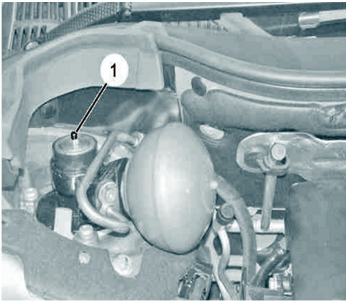

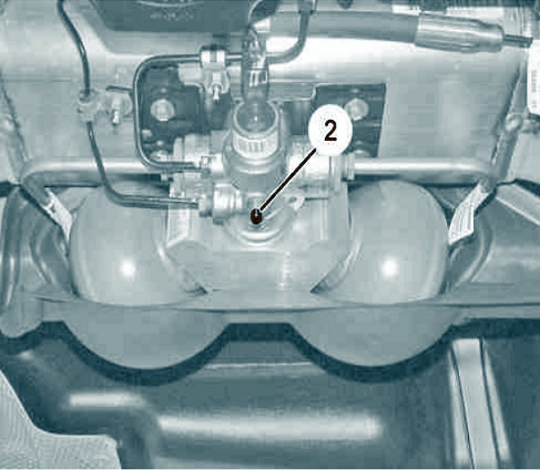

I’ve ordered a couple of new front spheres which should arrive tomorrow. I don’t have Lexia so will use the above procedure shared by Marc (Thanks Marc).GiveMeABreak wrote: 30 Jun 2020, 14:56
B) If you don't have a kit, you can manually depressurise the front or rear axles independently, depending on the spheres you are replacing.
Disconnect the battery.
Raise the vehicle and support on axle stands, wheels free.
You will loose fluid, so don't re-use any reclaimed LDS that comes out, so make sure you have sufficient new LDS fluid to hand.
BSI Reset / Battery Disconnect / Reconnect Procedure
How to remove the existing sphere? Is a special tool required or could I use an oil filter removal chain wrench, or a big Stilton wrench perhaps?
Also, is there an O ring seal fitted so I can buy new ones before starting?
Thanks
2013 Citroen C5 Exclusive Tourer, 2.0 HDI Automatic with Techno pack

Hi Steve. You will require a new large o ring seal - these usually come with the original spheres, but if you getting another brand, you'll need to check. As for removal, yes a similar sort of tool to a chain wrench, but as the shape is saucer;like, it may have some problems staying on. I think Elis put something between the sphere body and the wrench to give the chain a bit of grip and to stop it slipping.
