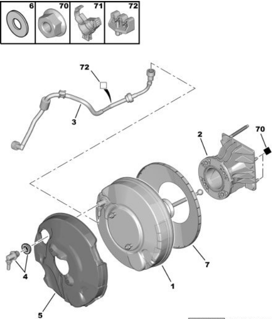

So first picture is the brake vacuum hose that runs to the inlet manifold. This is used to supply the brake servo and is used for the braking assistance when you hit the brake pedal. It has nothing to do with your engine performance.

Thanks Marc, do you however have the part number for the brake servo vacuum hose? Maybe also for the breather hose?
- x 6959
Re: Vacuum parts
The Brake Servo Hose (3) is part: 4578H7, costing £54.98 inc. UK VAT for reference.
