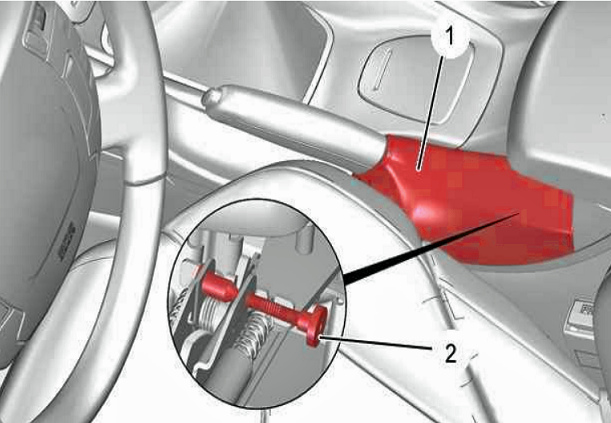

Here you go:
C5 X7 Manual Parking Brake Adjustment
Preliminary Checks
Raise and support the vehicle, with the rear wheels hanging free.
Preliminary Checks
- Raise and support the vehicle, with the rear wheels hanging free.
- Check that pad friction begins to occur from the first notch.
- Check that the normal travel of use does not exceed 4 notches.
- Check that all the cables are routed correctly (Parking brake)
- Check that the cables are not constrained (incorrect hooking of inner or outer cables, incorrect adjustment)
- Check that all the parking brake control components slide or move freely
- Adjust the parking brake
- Unclip the handbrake lever gaiter (1).
- Position the handbrake lever at rest.
- Action the integrated automatic adjustment unlocking button (2).
- Depress the brake pedal several times.
- Pull the parking brake lever on normally about ten times.
- Check the effectiveness of the handbrake.
- Check that the handbrake warning light comes on from the 1st notch of the total travel of the lever.
- With the handbrake released, check that the wheels can be turned freely by hand.
- Refit the handbrake lever gaiter (1).

I had omitted the checking part, so have now included this in my last post Steve.Steveo wrote: 07 Jul 2020, 05:17 Thank you Marc

As mentioned previously I replaced my calipers on the rear as one of them was sticking so using the wind back tool to push the pistons back I fitted the pads and made sure the handbrake levers on the calipers were on the stops.
The pedal seemed to have more travel than the original units and the hand brake lever also had more travel not to mention the handbrake not holding until it was pulled a substantial way hence the question regarding adjustment.
I gave it a while to bed in and self adjust which it didn't so following the advice I removed the handbrake gaiter and put the car in first gear
Using a long flat screwdriver I pushed the plunger towards the drivers seat and pressed the brake pedal firmly around 10 times I repeated the procedure again just for good measure and the handbrake is now fine and the brake pedal doesn't have as much travel in it.
