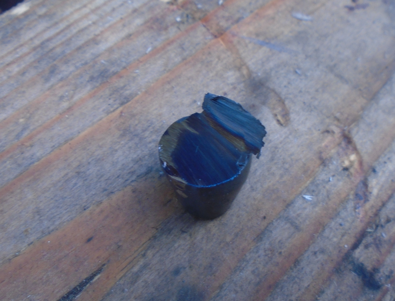

Here's one of the little irritations. Had to grind off the end of the "hanger projection" on the front downpipe because it was too long to poke through a fixed rubber mount , given the geometry of the convoluted pipe and the subframe and other random components in the way.
lets call it a nipple

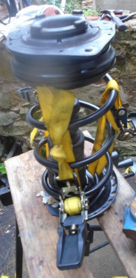

Morning....went OK decided just to get a new shock absorber (strut), got some nuts and washers from the local Agricultural Engineer, and got the old ratchet strap spring compressors out. Coil spring and strut done and dusted ready to put back on.

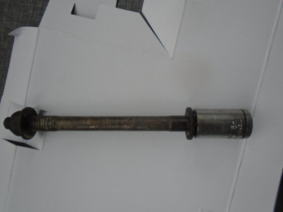

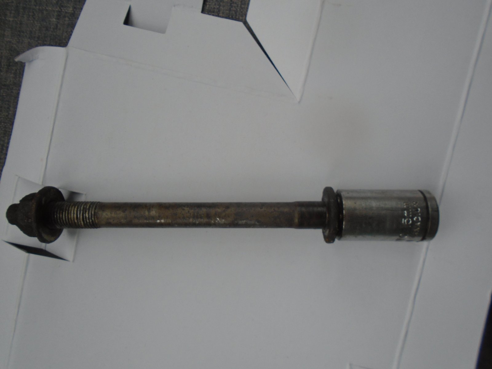

Even I am not mad enough to go out in the monsoon and finish the 2 MOT jobs on the BB Micra, so it was tool tidy and clean up time, and gather together the new parts so everything is at hand when the rain stops.
This is a 15mm socket hammered onto a rusty 16mm bolt head the only way of extracting it from the lower arm.
I might as well have welded it on. Its still not off and I have abandoned it for now. The chances of any Nissan parts department carrying a replacment bolt off the shelf I assess at nil, and furthur delay I am not looking for. One way or another its coming off.
Heat I hear you cry, I expect that will be the only answer, but with only the regular gas cooker in my arsenal its not going to happen. I may seek the necessary heat elsewhere.
Only other way grind a slot in the socket and break it. That to be fair could be my next step. I have spent quite enough time of tappy-tappy whacky-whacky with a hammer and a screwdriver and it hasn't budged.

How about putting the bolt back in through the new bush, doing it up and then twisty twisty with the breaker bar and scaffold pole? :)
Posts: 26425
Re: Bargain Basement Motoring
Thats a decent suggestion Mick, particularly if it works. Wonder if it doesnt whether the MOT man will pass it with a 15mm socket still in situ :-D
I am quite fortunate that the local agricultural engineer has a vast stock of bolts and may just be able to match one up in the morning, fixed me up with the one I had to destroy to get off.
Posts: 21329
x 8151
It is almost certain to work, as you will be undoing the motion which wedged it on when you took it off. If necessary get the scaffold bar end onto a jack and jack it against the weight of the car. :)
Posts: 26425
Hopefully that will do it Mick, I will look for a replacement bolt though, not that I plan to make a habit out of changing front lower arms, but there is something not very satisfying about a chewed up bolt head having to be re-used.
The car is 15 Years old now and I speculate as to whether that was an original lower arm. I wouldnt be surprised if that bolt has been in place for 15 years :-D . The MOT tester was bang on right though the ball joint at the hub was well and truly gone.
