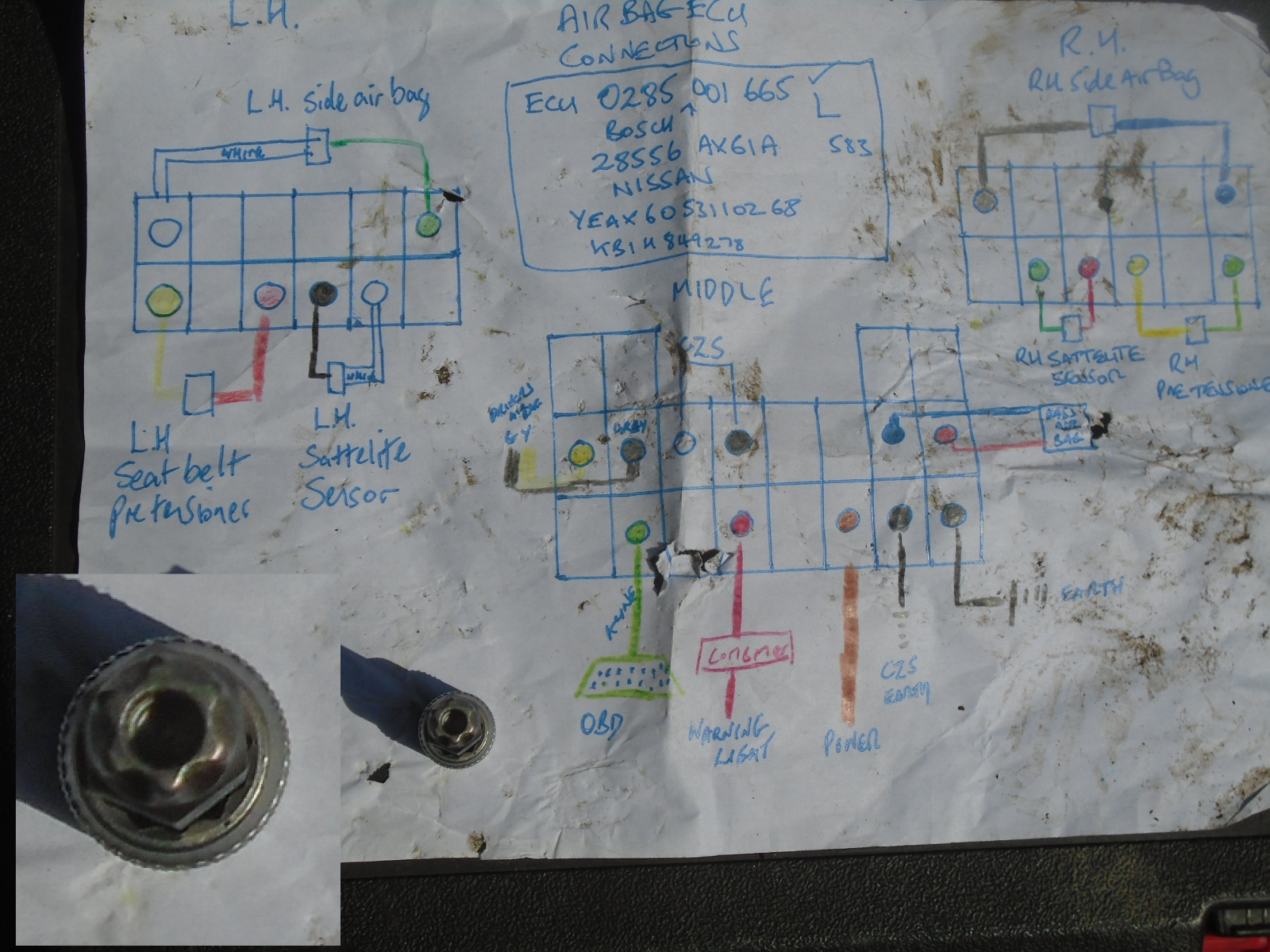

So I am happy to report my bit of scrapyard recycling reported on the Scrapyards and Scrapyard Purchases has resolved the Airbag light on the BB Micra K12.
and my little diagram which helped sort it out

Regards NeilNewcastleFalcon wrote: 07 Aug 2020, 18:16Treated myself to another visit to the scrapyard this morning. Following my nearly getting locked in with a large Alsation last visit, I decided against an afternoon visit.
I knew there were a series of Micra K12's in a row, so I went in search of a match of a few airbag (SRS) system components. It was useful research because each version of the car has a different level of equipment. Mine is the very basic Drivers and Passenger Air Bags, Driver and Passengers Pre-Tensioners in the seat belts, and a crash zone sensor at the front. Most other models have side-air bags in the front seats, and others curtain airbags.
So I found a match, and took away an Airbag (SRS) ECU, side satellite sensors left and right (my car has the wiring loom for these but not the sensors themselves) and two termnals for the side airbag wiring loom (which is present in my Micra but not terminated correctly-the car has no side airbags)
I only had a £20 so needed a bit of trim for the BB Corsa so got that thrown in too for £20 all told. Went away quite happy with that.

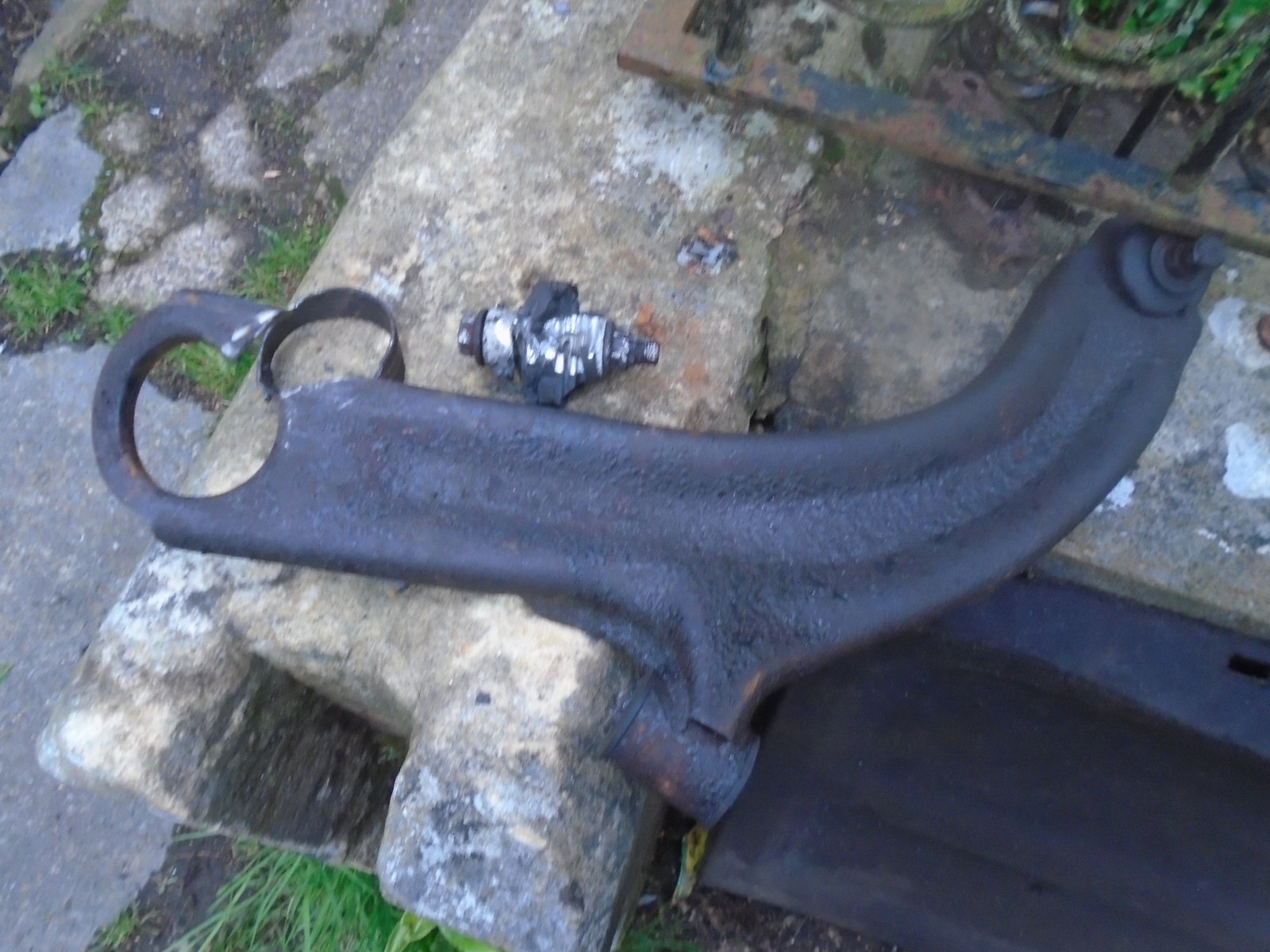

Morning....went OK decided just to get a new shock absorber (strut), got some nuts and washers from the local Agricultural Engineer, and got the old ratchet strap spring compressors out. Coil spring and strut done and dusted ready to put back on.
Afternoon.....Getting the one remaining bolt out of the lower arm. Started maybe 2.30 ish job complete 6.30 ish.
Predictable nightmare.
So here is the lower arm and the bolt carefully removed
No I didnt enjoy it!

This is a 15mm socket hammered onto a rusty 16mm bolt head the only way of extracting it from the lower arm.
I might as well have welded it on. Its still not off and I have abandoned it for now. The chances of any Nissan parts department carrying a replacment bolt off the shelf I assess at nil, and furthur delay I am not looking for. One way or another its coming off.
Heat I hear you cry, I expect that will be the only answer, but with only the regular gas cooker in my arsenal its not going to happen. I may seek the necessary heat elsewhere.
Only other way grind a slot in the socket and break it. That to be fair could be my next step. I have spent quite enough time of tappy-tappy whacky-whacky with a hammer and a screwdriver and it hasn't budged.

How about putting the bolt back in through the new bush, doing it up and then twisty twisty with the breaker bar and scaffold pole?

Thats a decent suggestion Mick, particularly if it works. Wonder if it doesnt whether the MOT man will pass it with a 15mm socket still in situ
I am quite fortunate that the local agricultural engineer has a vast stock of bolts and may just be able to match one up in the morning, fixed me up with the one I had to destroy to get off.

It is almost certain to work, as you will be undoing the motion which wedged it on when you took it off. If necessary get the scaffold bar end onto a jack and jack it against the weight of the car.

Hopefully that will do it Mick, I will look for a replacement bolt though, not that I plan to make a habit out of changing front lower arms, but there is something not very satisfying about a chewed up bolt head having to be re-used.
The car is 15 Years old now and I speculate as to whether that was an original lower arm. I wouldnt be surprised if that bolt has been in place for 15 years
. The MOT tester was bang on right though the ball joint at the hub was well and truly gone.
