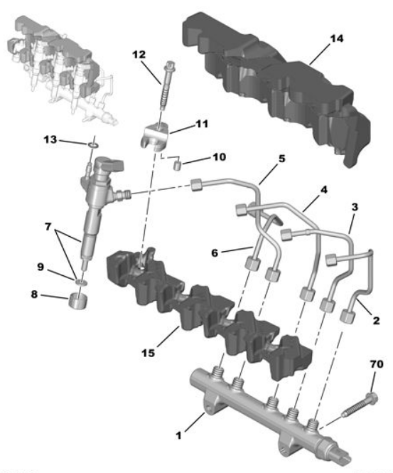

I seem to have lost the bolt at the end of 1570Q2

The bolt at the left hand side of (5)
- Posts: 9420
- x 1941
Re: Changing DS3 fuel injector
No 12) the injector clamp bolt?
If it's the same as on my car that should be changed anyway as it's a stretch bolt.

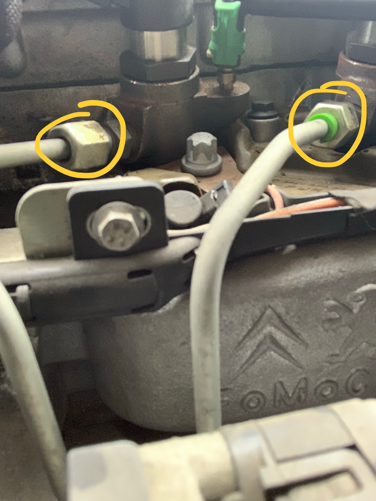

Just to confirm Paul- these parts? I’ve lost it on injector 4 but circled both of these for clarity.

Ah, not bolts - nuts.
Those are part of the pipe and shouldn't come away from the pipe. I think you're going to find a replacement pipe assembly. Marc will be able to post up the part numbers of the pipes.
- x 6946
That's the part he's quoted: 1570Q2 (Item (5) on the diagram. It comes as a complete part with the nuts on either end. They don't sell the nuts separately, but the good news is it won't break the bank: £12.72 inc. VAT.
Just make sure it is pipe (5) as each pipe is a different shape, so has a different part number Tom.
