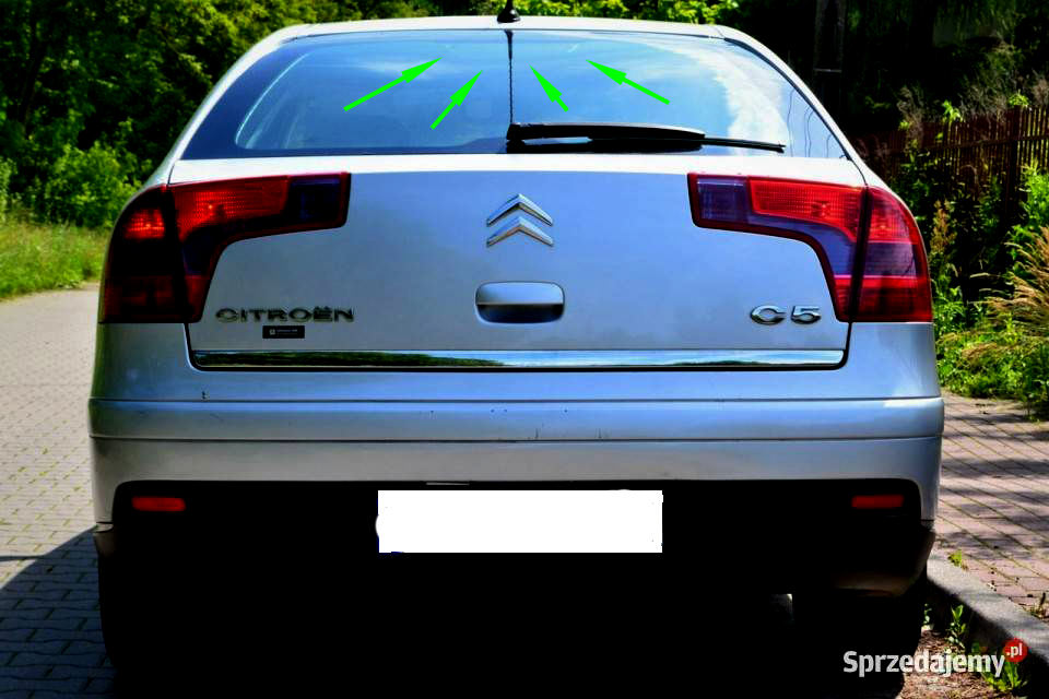

That's a bit garbled to be honest - are you asking if you should have a rear high level brake light on your C5 MK II saloon?seanrx wrote: 01 Jul 2020, 13:57 News to me.
My car's passed 5 MOT's so far.
This is why I need an owners manual. Ha!
So is it on non UK models only?
I do have a loose wire harness in that spot on rear screen, but always assumed it was for a non working de-icer.
If so yes - standard equipment. I've arrowed in green, you can just make out the shape.

So, mine is completely missing.
No assembly/mounting of any kind up there. But no mounting, would a tester know it should be there?
The glass is clean, no sign of a removal.

So it doesn't look like there's much to it for refitting it Sean.
Basically the unit has 2 bolts holding it in place. If you had the unit and were removing it from the car, you would push in the 2 side buttons of the cover, remove and then undo the 2 fixing bolts and remove the electrical connector.
So I suspect you could easily replace it if needed without too much hassle.
As for the MOT, don't they have a checklist that they tick off that would list the third brake light?
