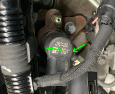

Do the injectors need coding in? I can't see anything obvious on the top of the injector (presumably hexadecimal) that would be a code.

Yes, they do and the code on your original picture for this specific injector is arrowed in green (B4FJKJ) in this example.

Yes, because a unique code is generated for each injector during the stages of manufacturing that specifically relate to the exact tolerance range of the needle and assembly. This info is needed by the engine ECU to provide the correct fuelling. Considering that the fuel is injected through a nozzle that it a thirtieth of the width of a human hair, it is important to code them.
Possible issues if they are not coded / coded correctly can lead to refusal to start, poor running, smoking, increase in fuel consumption, increased emissions etc., so not a good idea to leave this.

Interesting that the code is not hexadecimal and is only 6 characters long.
- x 6945
Re: Changing DS3 fuel injector
Just a Hex code on this one.

It can't be hex if it has 'J' or 'K' in it. It must be some other system.
- x 6945
I meant as of 6, not the abbreviated Hex. from Hexadecimal.

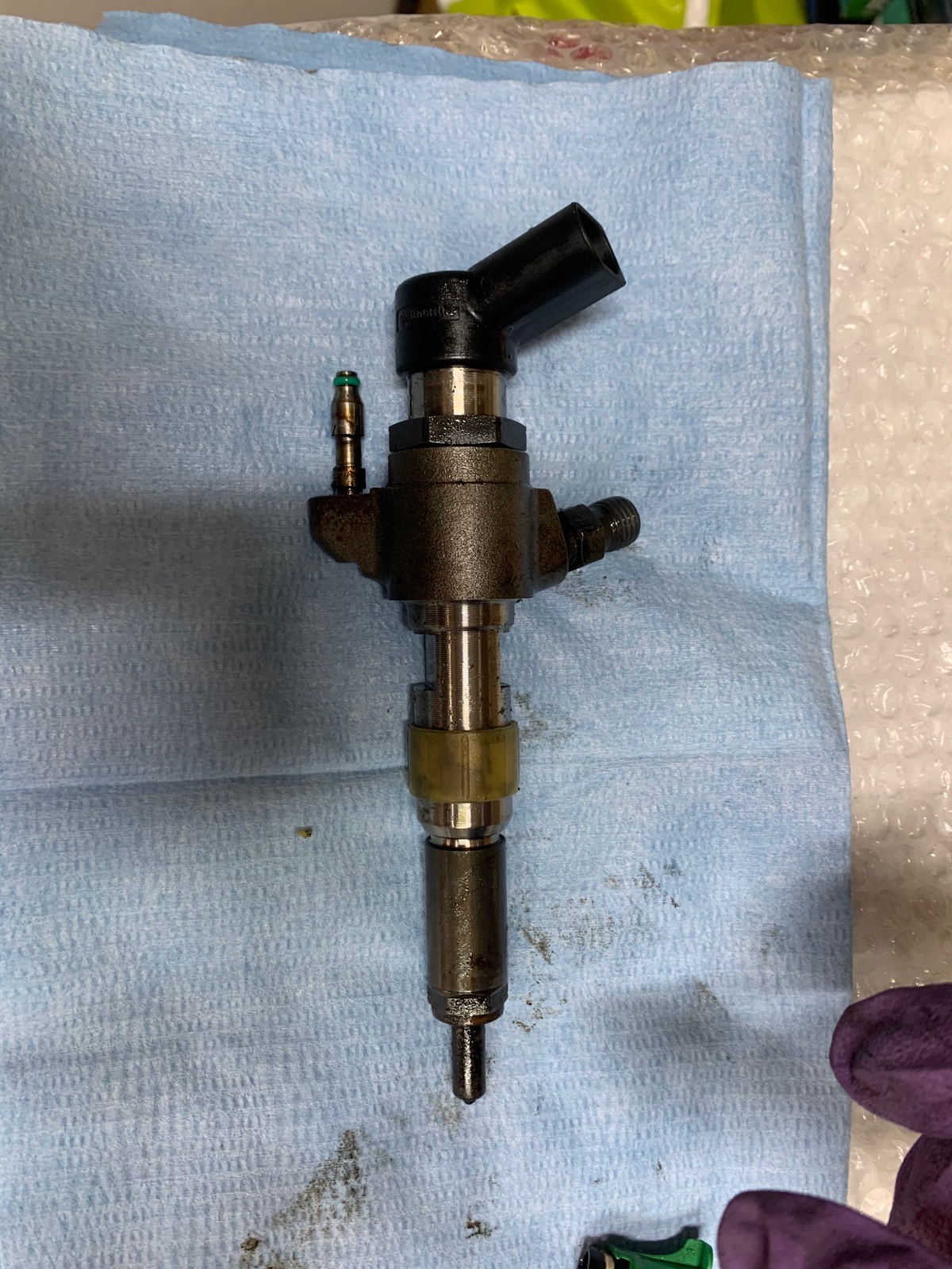

Ta dah!

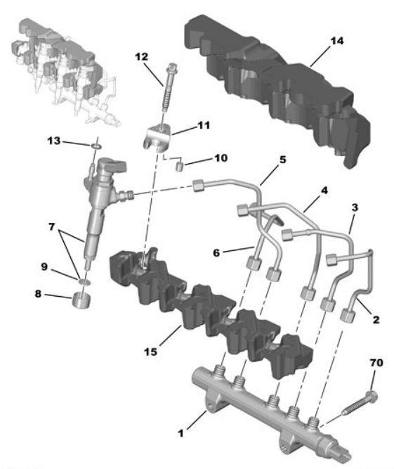

Waiting for the replacement to arrive. Can anyone provide the size I need for a replacement copper washer for the bottom?
- x 6945
Item (8) is Part: 1982G6 (Engine Injector Protection)
Item (9) is Part: 198194 (Injector Seal) 7.07/14.9 EP2.1-CN
