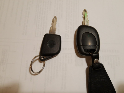

Some more. To day I got Clio into my hands.
I took all the relays off from cocpit and engine and also 433 MHz reveiver which is located central consol.
None was effecting to Immo. Both key worked like all the relays would have been on.
Here is my keys.
Left hand side key is passive key to 133 KHz. It work normaly.
Right hand side key needs to press key switch before it works.
It likes that active key switch should work as an passive. No battery. Like there is missing that 133 kHz circuit.

Re: Immo problem Clio mk2 E7J635, 1.4 L 8v, ym. 2000
Thank you your co-operation !
Well, another key that wasn’t coded in the car. Coded after Tantalum replacement.
The ESR was 3.2. Now it's 1.6. No more flashing light.
The second key, which works with the button down, was not corrected by the tantalum replacement, i.e. the button must still be pressed down.
The fault in this key is on the copper coil I had replaced. I ordered from Coilgraft, but the coil is different in structure and this
might be the reason the energy is not enough to ignite VDD!
