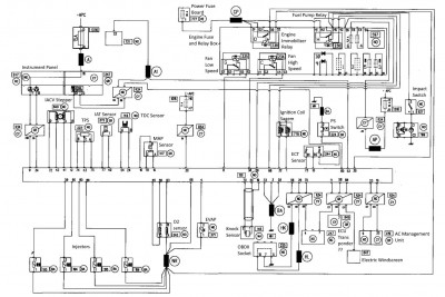

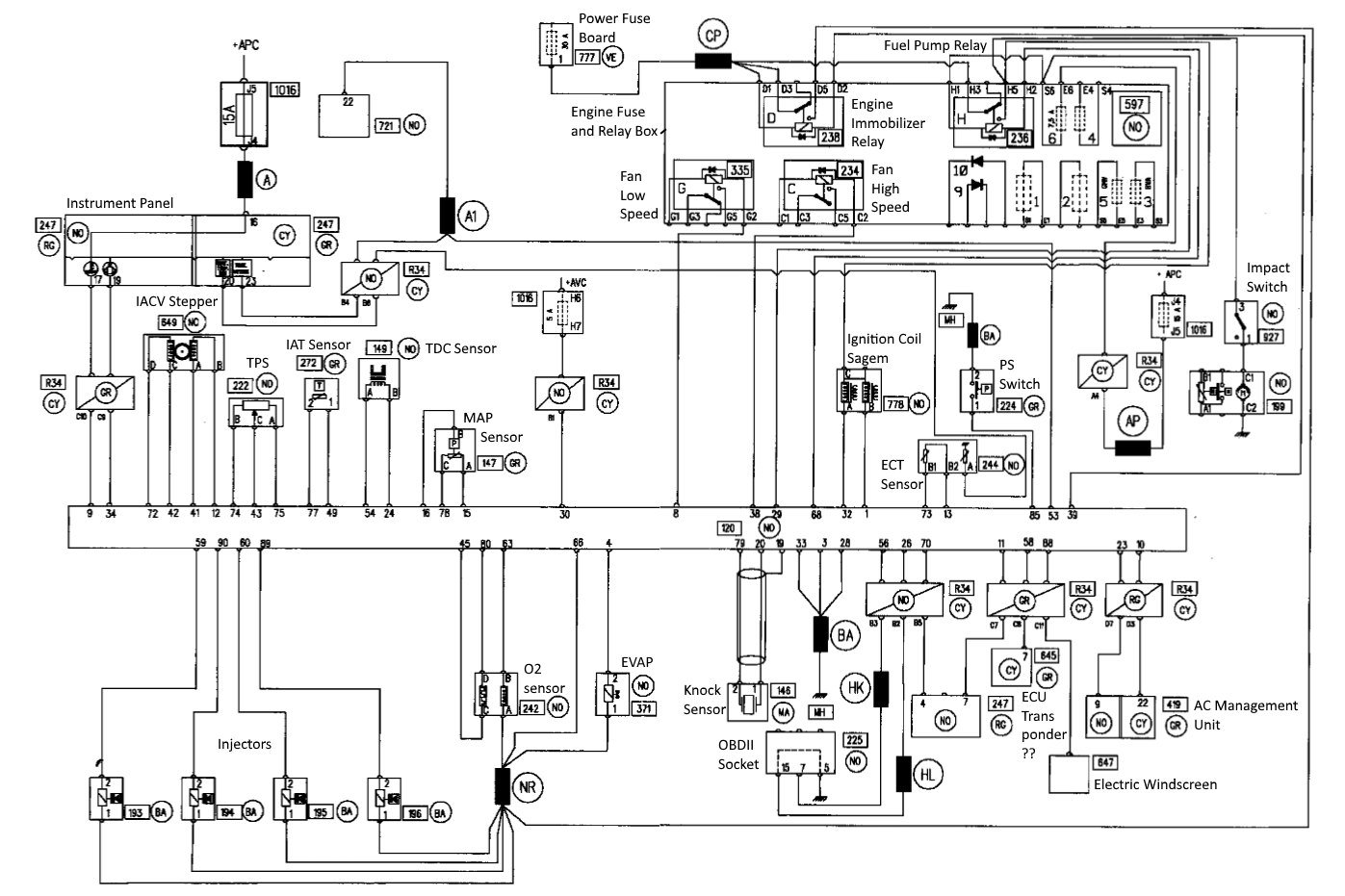

Wiring diagram would be nice from engine compartment ( ECU ) and also the relay unit ( BMT 4 ), which is on the left side of dashboard !
Here is picture of ECU system diagram, but this is newer model, perhaps mk3 or 4.
This is the best I could find on the net for wiring diagrams. It is for the Clio II but from 2001 so may not apply in your case. Through Marc and others, this forum has the chapter and verse on everything PSA via direct access to PSA information, but doesnt have the same access on Renault.
https://cardiagn.com/renault-clio-ii-fr ... -diagrams/

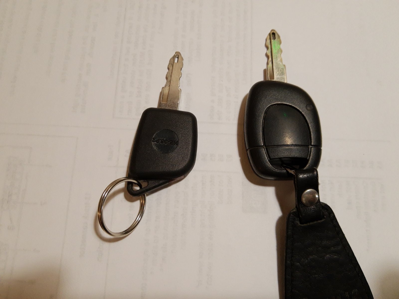

Here is my keys.
Left hand side key is passive key to 133 KHz. It work normaly.
Right hand side key needs to press key switch before it works.
It likes that active key switch should work as an passive. No battery. Like there is missing that 133 kHz circuit.

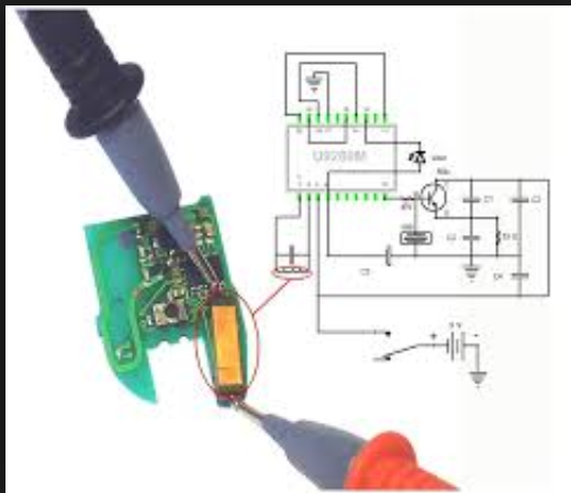

RFID coil around the key cannot creat enouhg power to wake up mickro circuit U9280M-H.
I goudn't attach PDF-file here.

Well, another key that wasn’t coded in the car. Coded after Tantalum replacement.
The ESR was 3.2. Now it's 1.6. No more flashing light.
The second key, which works with the button down, was not corrected by the tantalum replacement, i.e. the button must still be pressed down.
The fault in this key is on the copper coil I had replaced. I ordered from Coilgraft, but the coil is different in structure and this
might be the reason the energy is not enough to ignite VDD!
